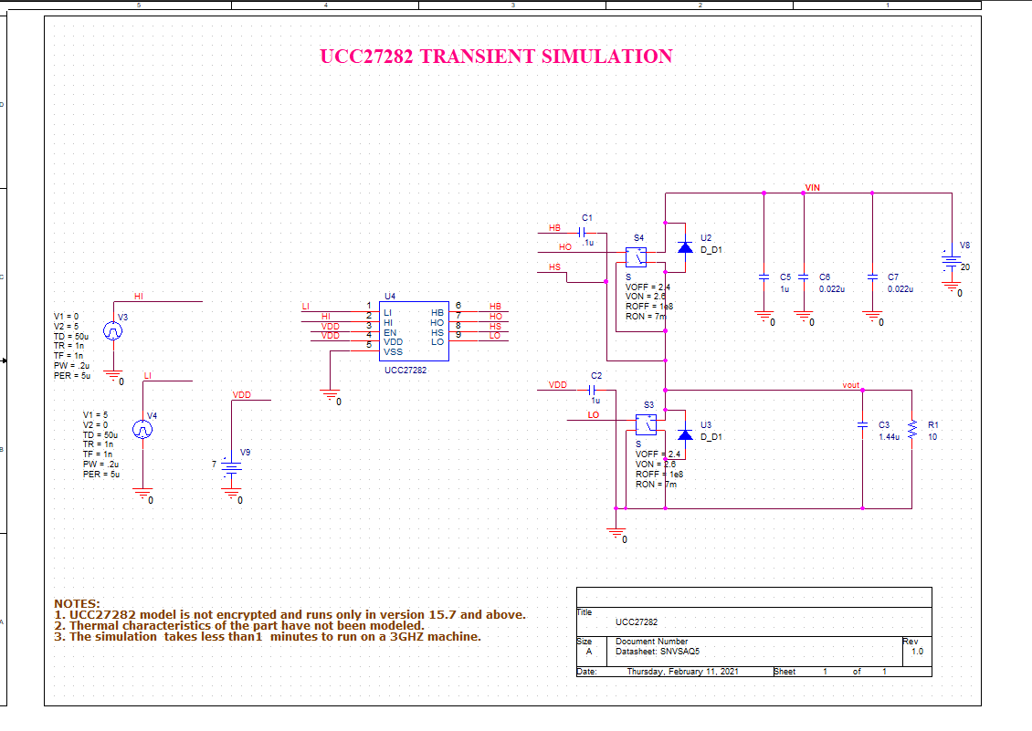

  • Hello Mamadou
    The signal on GATE_OUT(HO pin) should reflect on the HI signal as I understand. but I don't see the correct signal on the HO pin. Please see the attached plot in the attachment.
    Also schematic attached:
    0410.SCHEMATIC1 _ PAGE1.pdf

    ON your waveform, I do not understand why HI voltage is up to 35V while your schematic shows that V3 on HI should only be from 0 to 5V, can you confirm?
    Additionally, can you also confirm that X1 and the other FETs as well as the UCC27282 .lib file are associated to the simulation project. In some cases, the unencrypted .lib files might not be associated to the "model libraries" section of the project file.

    I have reviewed the schematic file and it is unclear why HS is connected to the drain of the n-ch FETs. This may be "confusing" the model as HO is supposed to be referenced to HS to enable the gate voltage on the floating FETs.
    To turn the FETs on, the model of the FETs and the driver expect to see a higher voltage on HO with respect to source of the floating FETs (HS) while your current setup appears to tie HS of the driver to drain in which case, MOSFET may not turning-on creating the convergence issues that your seeing.
    I suggest tying HS to the source and of the FET to allow the FETs to turn-on when the charge pump is discharging.

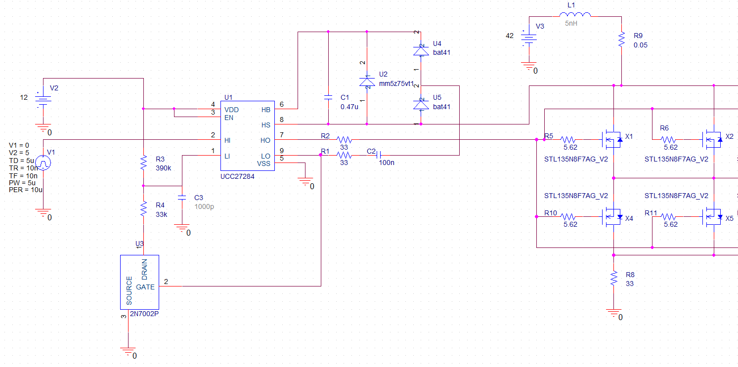

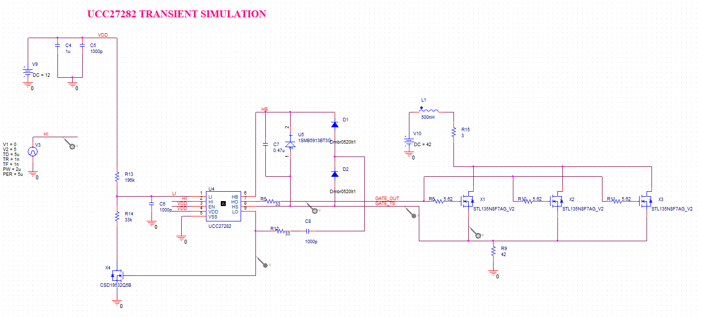

  • Hi Mamadou,
    I have connected the TS signal to the source of FET and it still stopping simulation at some stage. Please see Pictures of schematic, Waveforms, and output windows.
    Schematic:
    Waveform:
    Output window:
    Serhii

  • Hello Serhii,
    In looking at the schematic, this looks like a high side switch with the LO output being used for the HB bias charge pump. In this case, the LO and HO outputs need to be able to be on at the same time since LO will be switching when you want to turn on the HO output with a high on HI.
    For this operation the UCC27282 will have issues since this device has input interlock which will not allow LO and HO to be on at the same time. For this operation, use the UCC27284 which is the same as the UCC27282 regarding specifications but the UCC27284 does not have the input interlock and can operate with LO and HO on at the same time.
    Confirm if this addresses your questions or you can post additional questions on this thread.
  • Hello Serhii,
    My apologies for the delay.
    I have further reviewed your schematic and I failed to mention this last mention but the driver you're currently using is not suitable for this application given the internal cross conduction protection circuitry preventing HO and LO from being high simultaneously.
    I recommend trying the UCC27212 instead which has independent output LO and HO allowing to drive both channels simultaneously.

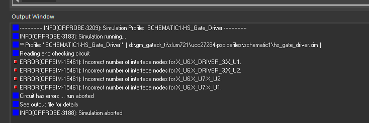

  • Hi Mamadou,
    Sorry for the late response. I have tried to run the reference simulation of UCC27212 with the reference design. And I could once, but after the restart of PSpice, I have got an error:
    --------------- INFO(ORPROBE-3209): Simulation Profile: UCC27212_Published-Published ---------------
    INFO(ORPROBE-3183): Simulation running...
    ** Profile: "UCC27212_Published-Published" [ E:\Downloads\slum588\ucc27212_trans-pspicefiles\ucc27212_published\published.sim ]
    Reading and checking circuit
    INFO(ORPSIM-15423): Unable to find index file ucc27212_trans.ind for library file ucc27212_trans.lib.
    INFO(ORPSIM-15422): Making new index file ucc27212_trans.ind for library file ucc27212_trans.lib.
    Making index file for library E:\Downloads\slum588\ucc27212_trans.lib
    Please be patient. This may take several minutes...
    ERROR(ORPSIM-15108): Subcircuit SI7368DP used by X_Q4 is undefined
    ERROR(ORPSIM-15108): Subcircuit SI7368DP used by X_Q3 is undefined
    ERROR(ORPSIM-15461): Incorrect number of interface nodes for X_U1.X_DRIVER_3.X_U1.
    ERROR(ORPSIM-15461): Incorrect number of interface nodes for X_U1.X_DRIVER_3.X_U2.
    ERROR(ORPSIM-15461): Incorrect number of interface nodes for X_U1.X_U7.X_U2.
    ERROR(ORPSIM-15461): Incorrect number of interface nodes for X_U1.X_U7.X_U1.
    Circuit has errors ... run aborted
    See output file for details
    INFO(ORPROBE-3188): Simulation aborted

  • Hello Serhii,
    It is not clear why the simulation ran once with no issues and then showed errors finding the device index files.
    I see that there seemed to be an issue with the MOSFETs as well as shown below.
    I would try downloading the driver and MOSFET subcircuit files again.

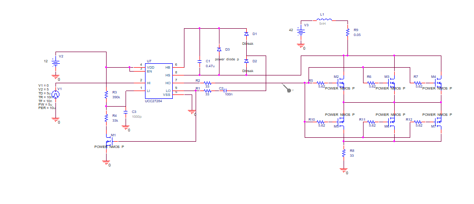

  • Hello Richard,
    I have created another project for UCC27284, and got another notification. Please see the schematic and notification:
    How can I run this circuit?

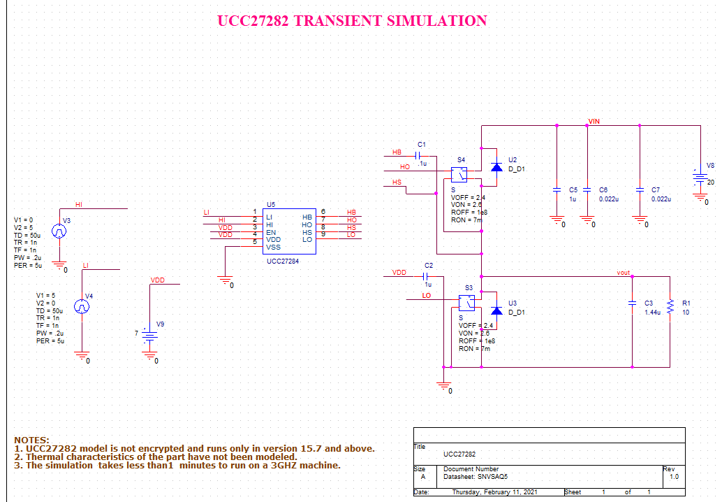

  • Hello Richard,
    Thank you for the direction.
    I have followed the recommendations, but I still can not run the simulation with UCC27212 and UCC27284; See the screen of the simulation. It seems, that the issue with models or way to generate parts.
    Reference simulation of UCC27282:
    Plot of UCC27282:
    Updated with UCC27284. Schematic:
    Report:
    Updated with UCC27212. Schematic:
    Report:
    Serhii
  • Hello Serhii,
    Thank you for the latest status and simulation images. In the case of the simulation using the UCC27284, I would suggest trying this schematic again since the error message indicates a limitation on the number of markers on the internal device. Which seems a little more clear than the error message on the UCC27212.
    As an experiment, on the UCC27284 schematic, run the simulation again, and when you get the error message click OK on the error message and change the number of markers in the marker settings. You will have to see what the setting is when you select OK, but I suspect that there are more than 3 markers selected. Change the number of markers to from 1 to 3, you can try both, to see if this resolves this error message.

  • Hello Serhii,
    Spice seems to have trouble with nets in the circuit that may have voltage ringing, high dV/dt or dI/dt.
    I see you have some inductance, L1 in the circuit which combined with the MOSFET model capacitance may result in voltage ringing. I would remove L1 for now and short the connection.
    You can try increasing the accuracy values in the table which means the engine can run with a solution with a wider margin of error.
    I would delay the HI input for a long period to allow the bias circuit to stabilize before changing state of the high side switch.

  • Hello Serhii,
    I looked at the schematic, and I think the HS pin of the driver needs to be connected to the source of the MOSFET's. Leave all other connections of the HS pin of the driver in place, and just disconnect from the drain and connect to the source of the MOSFET's. I think there is a conflict in the existing connection.

  • Hello Serhii,
    For the circuit to work correctly, the HS of the driver needs to be connected to the MOSFET source, or equivalent.
    For the error message, I think previously you confirmed if you select OK and change the markers to 1 the sim runs OK.
    I think it makes sense to do a couple of things. The schematic below ran OK based on your feedback, with the update to the UCC27284.
    I would take your application circuit and replace all the diodes with the diodes from below circuit, U2 D_D1, and replace the FET's with the ideal switches like S4. To replicate the FET's be sure and use the switch and diode in parallel to simulate the body diode of the FET's. You can just use one switch to try the simulation.
    The bottom two pins of the switch is the source, and should connect to the driver HS pin. Add a 10K resistor from the driver HO to HS pin so that there is not a low value current path, this may help the convergence issue.
