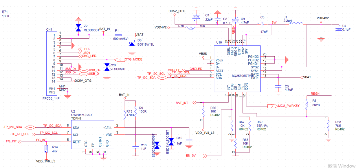

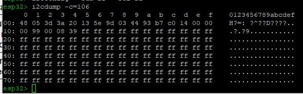

Hello, dear TI team.
In my application, I'm using BQ25895 IC for lithium battery charging and power management. But I have difficulties with that - IC doesn't charge the battery. When I connect the power supply (5.0V) IC consumes around 30 mA, meanwhile battery voltage is 3.5 V. When the power supply is unplugged on the PMID 5.13 V and on the VSYS - 3.53 V. I attach my schematic and I2C registers dump. What is happening and how can I put the controller into the charging mode? Firstly, I thought this is because of overheating the IC, so I resoldered with a hot air gun 4 more ICs, unfortunately, the result is the same.
5850.Schematic.pdf5481.PCB.pdf
 Thank you in advance!
