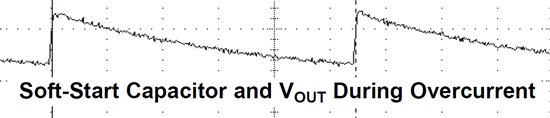

4 - Started with Switcher Pro calculated components and there was no expected output; 1.5V with 220 Ohm load, unstable approx 21V with no load.
     Wave form on the SS pin was the same with overcurrent situation as described in datasheet. (1.7Vpeak when unloadaed, 1Vpeak with 220 Ohm load)

5 -  I have added a added a resistor parallel with the Css to decrease discharge time. Played with the resistor value but it does not solve problem.

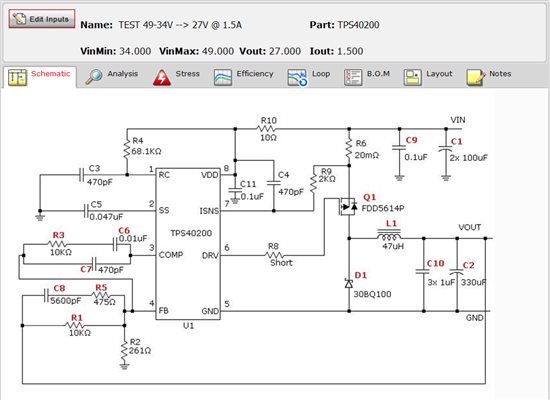

 Switcher Pro schematic;
 TPS40200 Switcher Pro schematic - YILMAZ KIRÇİÇEK
Applied schematic;
TPS40200 schematic - YILMAZ KIRÇİÇEK

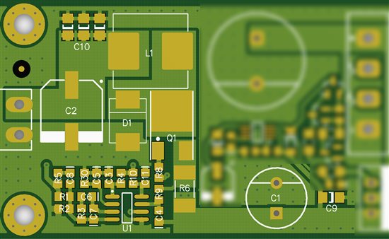

 PCB layout; (Two layer, bottom for power gorund)
TPS40200 PCB layout - YILMAZ KIRÇİÇEK
  • I have designed PCB before Switcher Pro update, so R10 is placeed where the previoud version advice.  Location of the R10 can be real problem ?
    The location of the capacitor in your schematic is correct.  This is the post-update location.  If it was in the pre-update location (in series with the power stage) it would be causing a problem as the TPS40200 supply would be trying to draw 27/34 * 1.5A = 1.2A of current through a 10ohm resistor (14W power dissipation)

    1) Insufficient Soft-Start time to charge output capacitor to 27V within current limit.  Your schematic shows 333uF of capacitance, charged to 27V is about 9mC of total charge.  The soft-start time programmed with a 47nF capacitor is about 470us for about 19A of soft-start charge current, which exceeds the current limit programmed with a 20mOhm resistor (which is 3-6A).  Changing the soft-start capacitor from 0.047uF to 1.0uF decreased this charge current to about 0.9uA.

  • Firstly lets see if the grounding of the IC could be the issue. Looking at your layout the IC decoupling capacitor (C11) is not in a good location. IC signal ground current shares copper traces with the power train switching current. C11 should be connected directly to the VDD and GND pins of the IC. The signal traces to the IC would connect to one side while the power traces would connect to the other. See figure 52 in the data sheet for the TPS40200. See how C3 in this figure is connected to the IC and how the signal level parts connect to the left hand side, while the power train connects to the right. You should try to implement this on your PCB. This may require cutting traces.

    I thank you for your advice. You were right, signal ground was sharing the copper trace with power train. One of the problem has caused by my poor PCB desing.
    Changing the decoupling capacitor loacation did not change anything alone. But when  I moved  the C3 (RC pin) and C5 (SS pin) capacitor ground connection to TPS40200 GND pin with a jumper wire first problem is solved. Now circuit can work healthy with resistive load and linear regulator + resistive load. And also I can able to disable OCP by shorting ISNS and VDD pins without changin anu other components. (compansation, output cap. etc.)  I will never make light of Kelvin connection importance and make such an error inşallah.

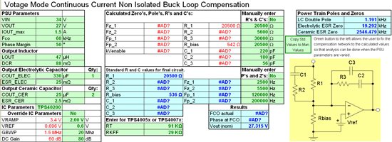

    I am going to redesign the pcb as described datasheet but want to be sure about stability.  As you mentioned I did not considered the switch mode supplies as a load. I want to use TPS40k Stability Tool but I could not achieve. #AD? appears instead of numeric values. Could you please gelp me to use it ?

  • Not sure why you are getting the #AD? error, I do not get this on my sheet. However I do see that the K-factor method isn't able to give a good loop. So I manually entered the poles and zeroes. I used the poles form the tool initial calculation. Then placed the zeroes at the LC filter double pole. The cross over is not as aggressive as your selection but we now have some phase margin, see below.

    I guess we are not using the same version of the excel worksheet. I can see it from the difference on left bottom side (Select IC section.) When I select TPS40200 a new section appears. Could you please send your xls file to me ? (via e2e or yilmaz.kircicek@teksanjenerator.com.tr
    Best Regards.
  • I ran the same inputs on the version found on the web and the results were the same.
  • So I am going to struggle with Excel setting (macro, security, add-ins etc.)  or going to try it in another PC.
    Regards.
  • What version of Microsoft Excel are you running?
    I have seen people having issues with the Excel tool using the European version of the Excel 2003.  This may be that issue.  I will see if I can find the issue.
