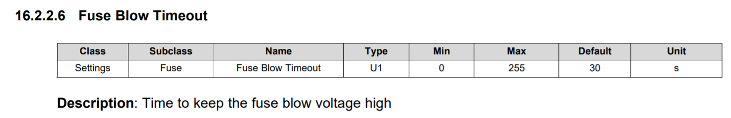

My customer is using BQ40Z50 and would like to know the status of fuse blow voltage if the timeout is set to 0. According to datasheet, the fuse blow voltage won't go high at all, is that correct?

Yes it should never set the fuse high if the blow timeout is set to 0 sec.
You can also disable the fuse with the FUSE_EN function.
