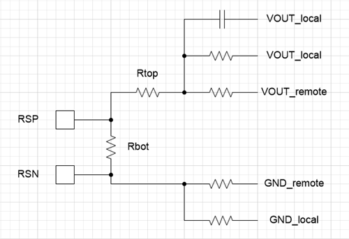

    2. Due to the diviver between RSP and RSN, how to route the trace of RSP and PSN as differentional?  Should VOSNS and RSN be routed as differential according to picture showed below?
    Unfortunately your images did not come through correctly, so I can't comment on the images.
    However:
    1) Yes, VOUT_MODE is read only and can not be changed, and the LSB from VOUT_COMMAND to RSP - RSN is still fixed at 1.9531mV / LSB, but since VOUT is not directly connected to RSP, the LSB of VOUT is not 1.9531mV, but is 2.188mV since ever 1.9531mV on RSP - RSN translates to 2.188mV at VOUT.
    2) Below should be an image of how to route VOUT sense points back to RSP and RSN.  In this example there are 3 VOUT sense points.  There is a local resistive VOUT sense point for VOUT and GND, close to the output of the TPS549B22 converter and a remote resistive sense point.  The TPS549B22 will regulate the output voltage based on the average between these two, weighted by their sense resistance.  Typically designers will select a resistor value 10x higher for the local sense so that the remote-sense can maintain an accurate regulation voltage at the final output voltage.
    There is also a capacitive connection to the local output.  This is useful when there is resistance and inductance in the power delivery path between the TPS549B22's local output and the remote sensed output close to the load.  The capacitor allows the converter to compensate for the power-path delay and stabilize the full loop despite the phase lag introduced by this parasitic power-path filter.

    What is the recommended value of your attached sense circuit?
  • HI Peter,
    can you please help to  review my schematic design? Thanks
    Typically R2 and R3 (Remote Sense Resistance) is fairly low, between 10 and 50 ohms.  10-Ohms is typically a good value to select.
    R1 and R4 is generally 10x R2 and R3, 100-ohms to 500-ohms.
    C1's value really depends on the layout and the parasitic inductance and remote capacitance.  C1 might not be populated at all, or it may be sized to form a zero with R2 to shift to local feedback at high frequencies.  Typically the zero is located just below the poll created by that parasitic filter.
    The schematic looks pretty good.  I see an estimated 10mV of output ripple and 27mV of transient deflection on the output voltage on a 20A load step, so make sure those meet your requirements.
