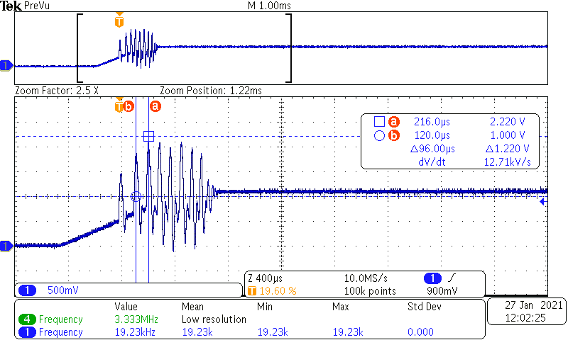

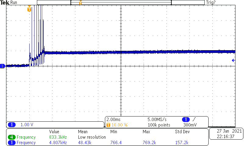

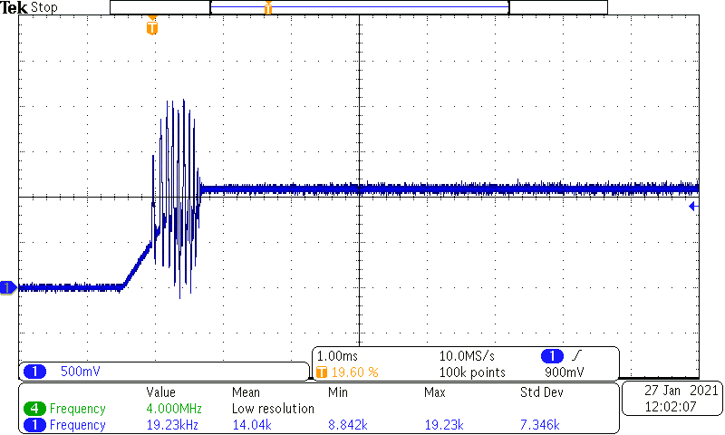

I was troubleshooting a design that uses the TPS56C20, and had ringing in some conditions (5-10kHz ringing on output - obvious as audible inductor whine). It seemed to be related to my test setup & large inductance leads. But I then noticed a ringing around the same frequency on turn-on (much shorter - but still present) after changing around the load setup.
I'm seeing ringing on the device during power-on. It's more noticeable at certain loads (often ~3-6A), but seems to always be present. Using the dev board "fresh from the box" I discovered it also happens there too (my next step in troubleshooting was getting a "known good" example) - see these photos:

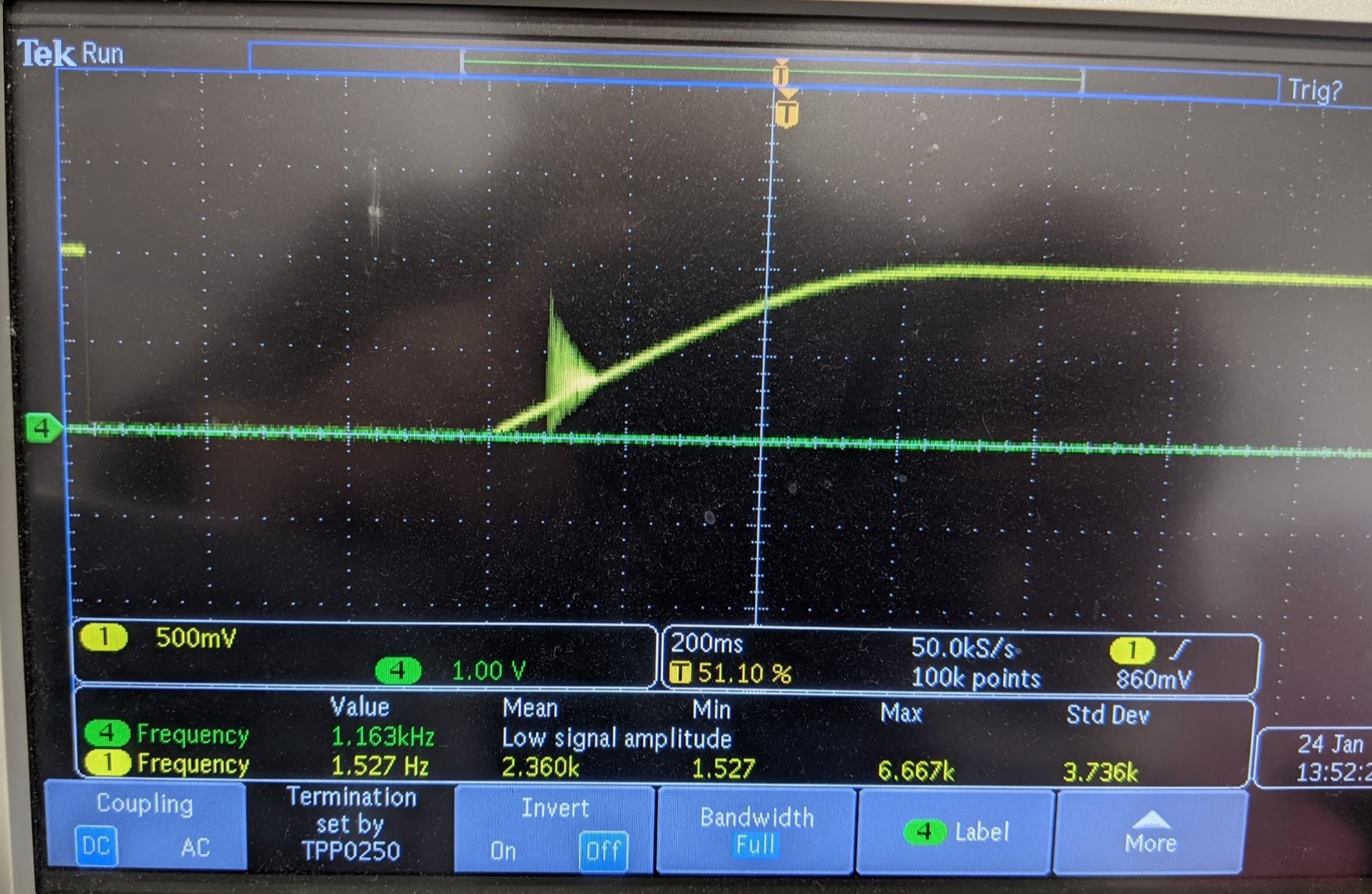

On my own board - if I slow down the turn-on time by changing the SS capacitor, you still get it even with an insanely slow turn-on time Yes that's 200ms/div):

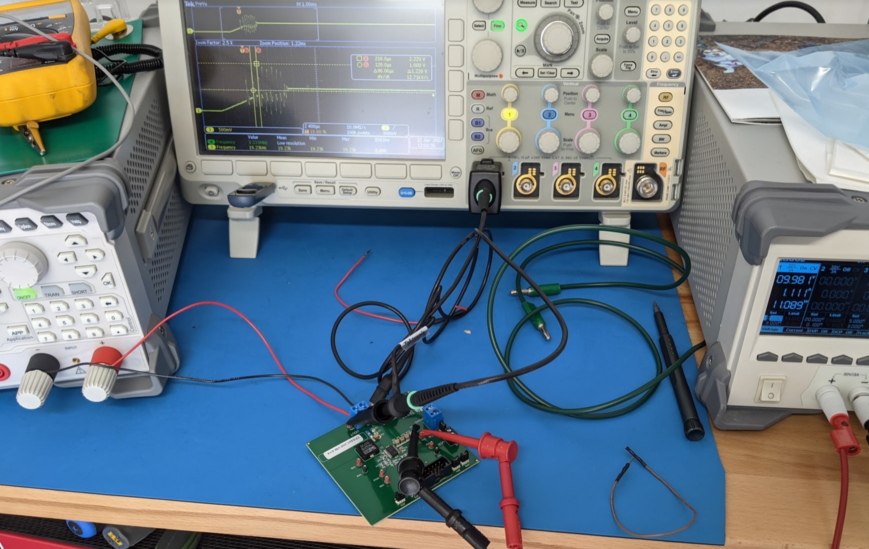

Going back to the dev board, here is my setup:
I get this ringing regardless of input voltage and for many current settings. The load is a DL3021. Is the test setup wrong somehow or is this an issue with the part?

    Slow start-up ringing:
    Test setup:

    According to your test setup on EVM, some suggestions:
    1. Don't connect Eload, does the issue still have?
    2. What is the input voltage and input current limit?
    3. The output wire connect to Eload is too thin. Recommend to use thick wire to test with 3-6A loading.
    4. If you still have the issue, please help to capture the VIN, Vout, SW and Iout waveforms together. We need to check the waveforms for further analysis.

  • Thanks for checking you aren't seeing that - I did a lot more investigation and finally wondered if my electronic load was the issue all along. Indeed just connecting another PSU to the load shows the same turn-on ringing when going through 0-->1V.
    I rigged a load for the dev-kit using a spool of wire that had enough resistance to give me ~5A and there wasn't any ringing issues at all (and this would be a rather inductive load). Will switch to some power resistors for rest of testing once they come in. Appreciate the confirmation!
