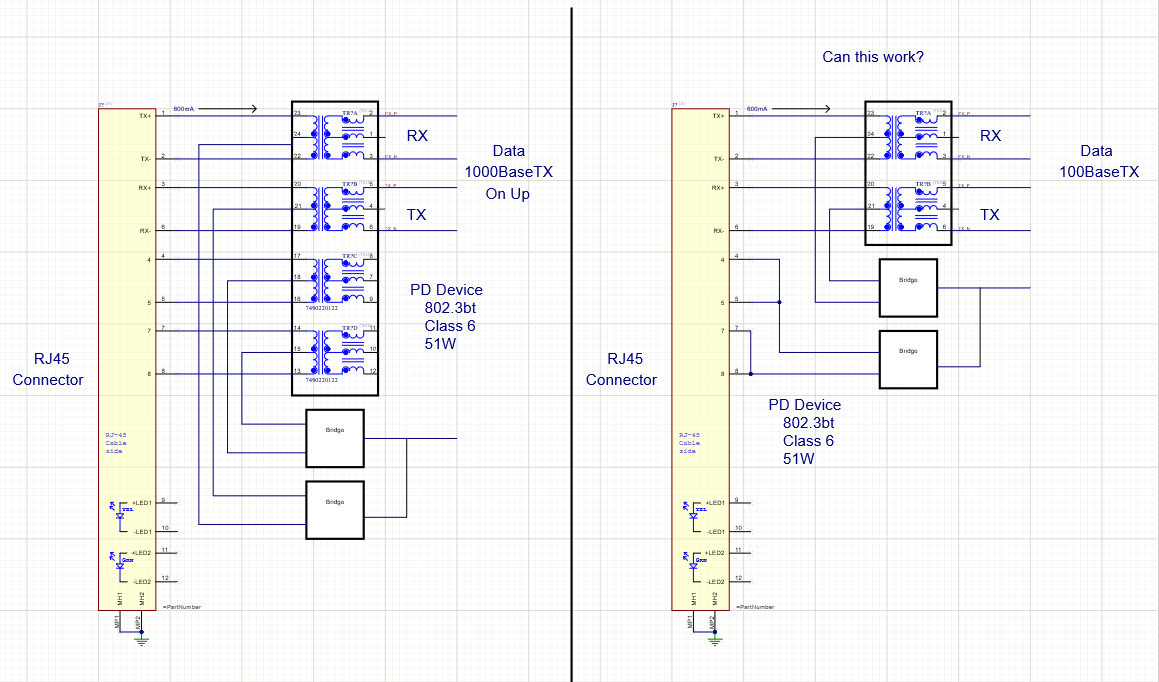

I am designing a POE++ PD device that operates up to Class 6 and has a 100BaseTX data interface and looking for components for the front end that conserve real estate.
There are fewer integrated choices at this level and it looks like the only 802.3bt magjacks and circuit examples ar for 1000Base T and up with a transformer for each wire pair.
Is it required to have a transformer for all wire pairs in the 802.3bt standard or can I use a smaller Lan transformer for the TX/RX pairs and tie the other together?
Also I would like to understand the current paths on this topology. A popular chart says that the maximum current for type 3 4PPOE  is 600mA per pair. What does this look like on a diagram?
This is a diagram of what I am thinking of.

    As for the requirement, 802.3.bt is meant to support 100baseTX. When you say you want to tie the pairs together, where do you intend to tie them?
    The pairs are tied together after the rectifier.
    if you mean to tie them together before sending the power over the wire, that would result in more power loss in the cable and probably require a higher class. I am not sure if  PSE can even support that. .bt PSE's can support two pair if it is sending .at or .af power levels..
    Additionally, why could you not send data over two pairs and power over four?

    I uploaded a diagram that shows what I am describing. In Type 2, 2 pairs are used to send power. Two pair are for data and power, and the other pairs are "spare" and are tied together at the RJ45 Jack. -  all pairs  are rectified.
    In Type 3, all 2 or 4 pairs carry power otionally, and all designs I have seen terminate at the PD side at transformers before being rectified. In a 100BaseT system these transformers are not used to pass data so they only there to hook up the "spare" pairs.
    My example depicts sending data over two pairs and power over all pairs as you pointed out. How these should be terminated is my question.
    Also, gicen a 4 pair power system, I am trying to understand how the currents travel through each pair and at what level.

    I reviewed the circuit drawing you sent me, and I think it is possible but I have some reservations. First is that 4 pair power must be used for 802.3.bt, so it will go through all four pairs.
    Second, the PSE can do detection through either pair sets. However, the impedances between pairset A and pairset B will be different, so I caution you that one pair set may not pass detection. If a particular PSE only detects on one pairset (as some software feature), it could potentially never power up.
    Third is that 802.3.bt power is supposed to be balanced between the pairs, and now that the impedances are changed, it might affect the PSE.
    So technically yes you can try it but these are my reservations.

    I believe you may have answered my question regarding the extras transformers - All fours pairs need to be balanced for proper detection.
    That brings up a couple other questions:
    - If only 2 pairs are used for power and data in type 1 and 2, then why are the "spare pairs" rectified if they do not carry any current - or might they?
    -  I am seeing all 802.3bt design examples where all 4 pairs are being used for data transmission while 802.3af/at design examples seem to use only 2 pairs. I assume this difference is in regard to the ethernet physical layer used: 2 pair for 100Base-Tx and 4 pair for Gigabit Ethernet. In my application, I only need two actual transformers for 100Base-TX data isolation - in a 4 element package, the other two are only used for impedance balancing so I am wondering if I can get by with a cheaper fast ethernet LAN transformer and use cheaper/smaller inductors to balance the other pairs. Might this be compatible in a network?

    We rectify the power incase anything nonstandard happens.
    I cannot speak to the data side of ethernet. I suggest posting this question on our Ethernet PHY team's E2E forum.
