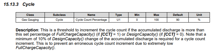

A cycle count error occurred in the battery pack using bq40Z50. (The count jumped from 100 to 13000)
bq40Z50 is not sealed.
This is probably due to the effects of electrical noise.
But why does it not affect other settings and only the cycle count?
Is there any other cause for the cycle count to jump besides electrical noise?
