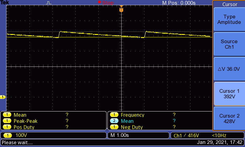

We are facing initial no load voltage fluctuation please give me the solution.

Hi M.Prathap
at no load condition, there UCC28180 will works at burst mode due to loop calculation, so there should be a little fluctuation, but it should be very small.
Please add the waveform for further analysis.
Prethap,
The waveforms shows OUTPUT VOLTAGE PROTECTION(OVP_H) is triggered. And then driver of UCC28180 is stopped and recover when output voltage drop to 102% of regulated output voltage.
Could you try to speed up voltage loop response?
Yunsheng

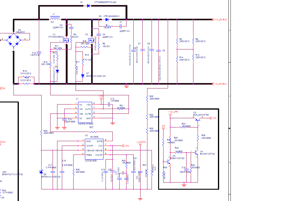

Here the design details below.
Design output details
Schematic
Facing issues
Please resolve issue.
Senatla IN
after using correct 0.005E, is the issue of output voltage fluctuation fixed?
Regarding to the
what is the output load at this condition?
Here is my suggestion, startup with no load fristly. And apply load when the output voltage is ready. Since there is no brown-out function with UCC28180.

After pacing correct 0.005E shunt we are not able to observe voltage due to DUT fail.
Senatla IN
Hi, Senatla IN
I think you need to fix the board first.
PFC is the front end stage, there is second DCDC stage following PFC. So to PFC, during startup of PFC, there is no load to PFC. It is kind of no load startup.
what is result, if you startup PFC with no load? Can you observe output voltage?
Yunsheng
Hello Yunsheng,
We are startup PFC with no load only, voltage reaching to set voltage but once reaching voltage DUT fails.
*For the same we are found issue in PCB layout and it fixed. Now PFC working fine.
