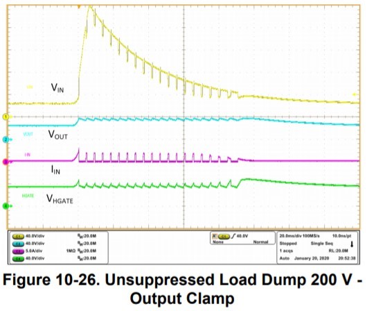

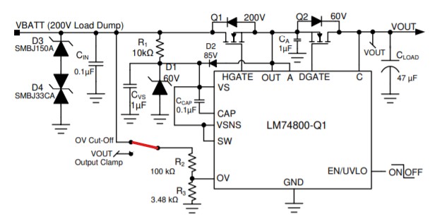

I am intending to limit inrush current within 30 and 40 A when the output capacitance is 1500uF. According to the equation from the datasheet, the CdV/dt should be around 2.2nF.
The design nominal output current is around 30A, and the output power is around 0.5kW.

There should be no problem in using Cgate if you choose to cut-off the HGATE (like shown below) when there is an over-voltage event including Load Dump.
It is not recommended to use Output Clamp option as during clamping the Voltage across the FET can be as high as 140V (as shown below) and the load current in your case is around 30A. The power across the FET is too high for the FET cannot withstand it for longer durations due to SOA limitations.
