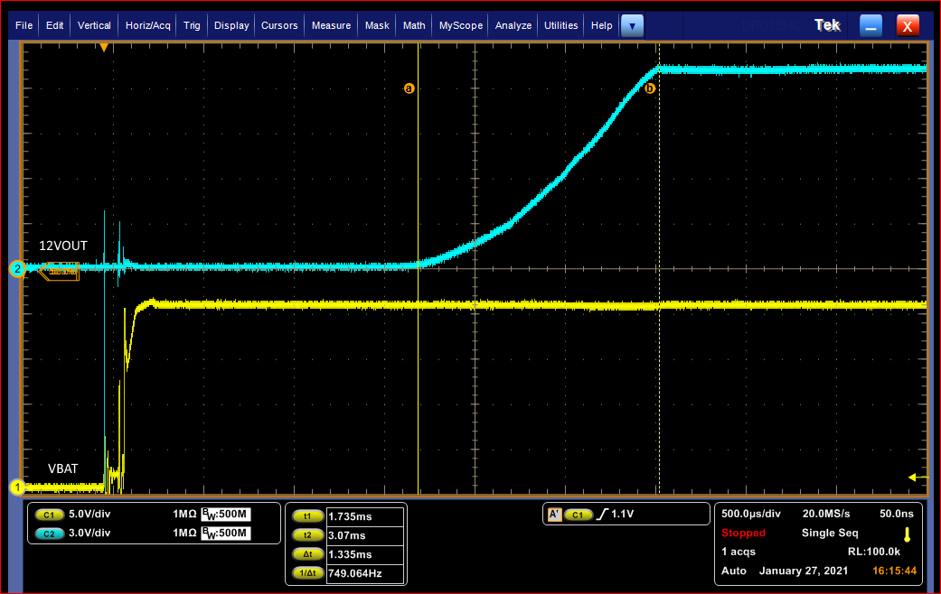

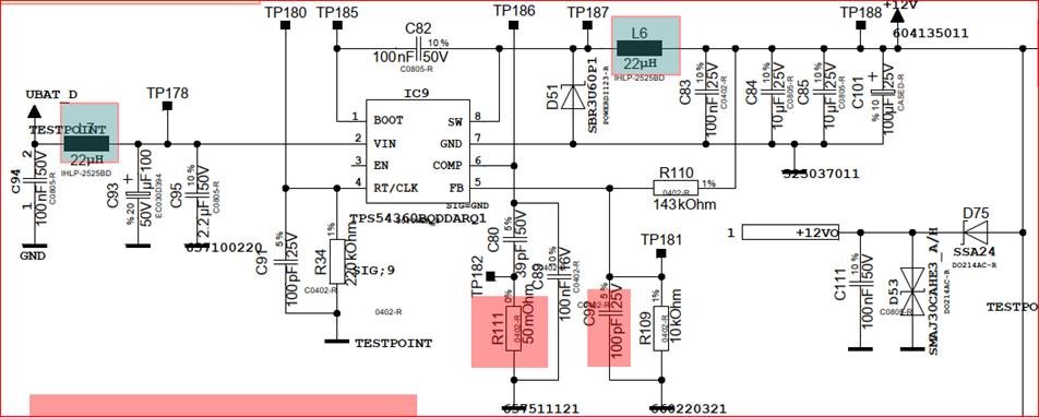

My customer have an off road ECU application where we are using the TPS54360 PWM IC to create a 12V supply from VBAT.  I have a technical question about the power up transient shown in the image below.
I interpret cursor a to cursor b to be the soft start time with a rating of 2.1mS.
What causes the delay in 12V output creation between the application of VBAT and cursor a?
