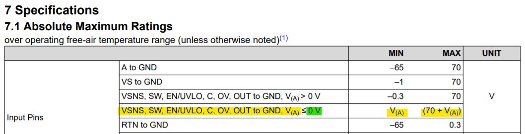

  • Regarding your second question,
    During reverse polarity protection, the 'A'  pin of LM7480-Q1 will be connected to the -ve voltage.
    The other pins of the IC as highlighted below are rated for V(A). So there should be no problem in connecting EN/UVLo to Vbatt.
  • Hi Praveen,
    Thanks for the detailed responses. Understood on the EN/UVLO reverse input maximums... I overlooked that second row in the table!

    2. Assuming AC rectification is not required, I was just hoping to achieve reverse input protection for up to -45 Vdc in my application. Seems like the LM74801QDRRRQ1 can achieve this.

    1. Yes, Your understanding is correct. AC rectification is mainly required for Automotive Battery Applications. This may not be required for your application.
    2. Yes, LM74801-Q1 can be support  for -45V dc reverse input polarity protection.
