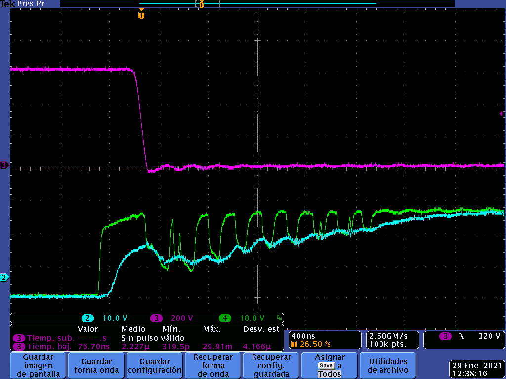

    Indeed we have a prototype and we the same effect in real life. The attached figure shows in channel 2 the signal measured in the gate of the SiC module, in chanel 4 the Vds of the module, and in channel 4 the OUTH of the UCC21750.  In fact, we saw this effect first in real life and trying to find out what was the reason, we made the simulation and realized that the same effect can be seen in the simulation.
    This figure shows the signals of the Low side mosfet of on of the three phases of the inverter. The Ron and Roff are 2.2Ohm

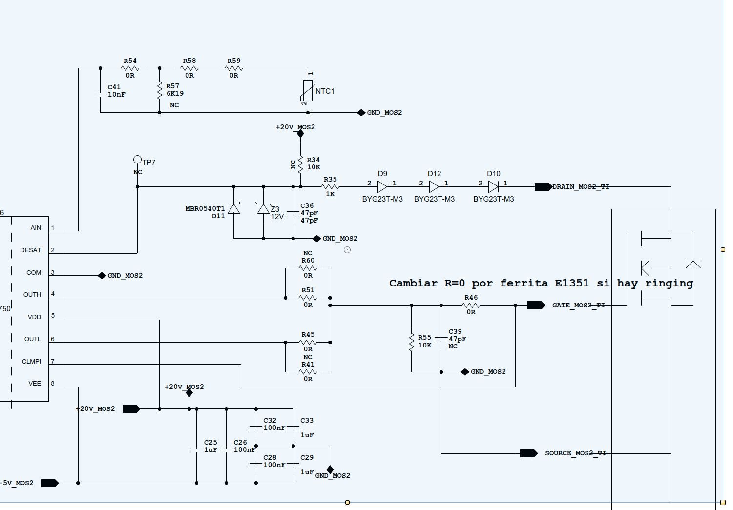

    The schematic is the following

    Thank you for the detailed information. From the waveform it seems like the gate driver is being properly turned on, but supply collapses when turning on the gate of the SiC FET. Gate oscillations could be due VDD supply collapsing during the turn-on transient and/or and a big gate loop inductance. This would explain why a bigger capacitance on the pin would help the oscillations as it would slow down the turn on transient. Would you able to confirm and or share details of the following:
    1. How close are capacitors C25, C26, C32, and C33 to the VDD pin of the gate driver? (A screenshot of the layout or a picture of the board would be helpful. Let me know if these are located in the opposite side of the board as the gate driver)
    2. How long is the connection between the gate driver OUTH and the SiC FET gate, and between the SiC FET source and gate driver COM pin? (Screenshot of layout of picture of board showing the traces would be helpful)

    We finally found out where the problem was. I was sendidng the control signals via LVDS from another PCB and under some circumstances  noise was getting into the system. I changed LVDS to 485 and the problems was solved.
    Thank you very much.
