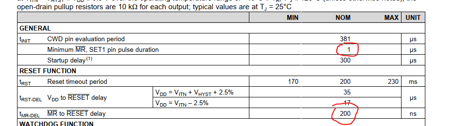

Hi Expert,

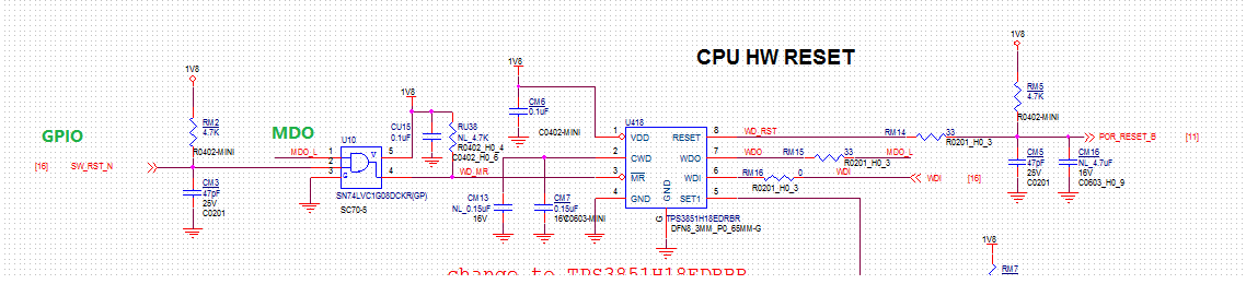

May I know if we have Tinit and Tmr-del (minimum and maximum) spec for TPS3851? Customer used TPS3851 with Qualcom IPQ6010 CPU and it has a pulse timing requirement from MR to RESET.
Thanks.
Allan
  • Hi Allan,
    Unfortunately, we do not have the min and max data that you are requesting at the moment.  Let ask around and get back to you but the likelihood of getting the information is very low.
    Ben
