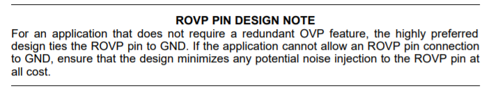

My customer has used TPS53318 and TPS53319 at their products since 2019. They designed their application circuit based on Rev.E datasheet of TPS5331x (SLUSAY8E). They leave ROVP pin floating.
<TPS5331x datasheet Rev.E>
However, the latest TPS5331x datasheet Rev.F changed the ROVP pin design note.
<TPS5331x datasheet Rev.F>
My customer designed that ROVP pin was left floating based on the Rev.E, and they have used the TPS53318 and TPS53319 on their boards.
It they continue to use the TPS53318 and TPS53319 by making ROVP pin floating, what would happen on their application?
Can they continue to use the TPS53318 and TPS53319 by making ROVP pin floating?
