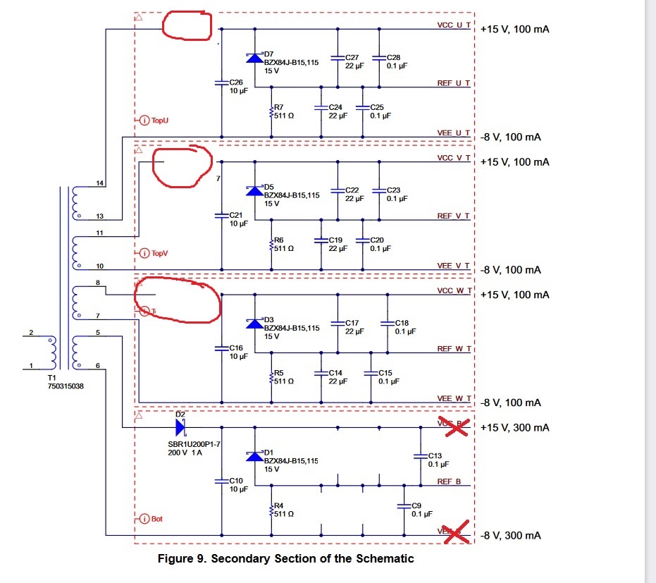

    The only difference with the Application note, is that we power 1xAMC1304 on the 300mA output, one on the first 100mA output and one other on the other 100mA output
    Edit:
    I just try to disconnect all AMC1304, the result is the same.
    The current consmption on secondary (300mA) is 40mA wherase no gate is yet used!. I don't explain this current condumption into the gate driver only!
    When I decrease the input power, the ouptut stay at 24V, but the current consumption on rectifier diode increase up to 80mA before shutdown when input is about 15.9V
    Note: the gate driver are TLP5772
    I made the following scheme:
    With this, All it's Ok...!
    Now, just I replace C12 which is a 22µF on 15V way on 300mA output:
    In this case, I decrease slwoly the 24V input, then under a certain voltage (about 15.9V) we sse the the phenomen where secondary transfo is Ok on negative pulse, but the positive pulse not increase.
    From this, never we will recover the normal state when input will increase.
    If now I decrease the input voltgae fastly, then the secondary transfo is zero, no strange phenomene with two negative pulse and positive tranquated.
    To say in other word, the problem is on the shutdown, if output voltage decrease too slowly (due to capacity) then the "strange behavior" occurs.

    But it looks like yellow is Vpri (buck output) and blue is SW. I thought it was a typo so I'd like to confirm.
    Comparing TEK00012.TIF to TEK00015.TIF shows that the blue waveform goes lower for the OK state (-40V? vs -20V?). If you're measuring as I described above, that means SW is going higher for the OK state. This can only happen if VIN is lower for the NOK state or if the BST capacitor is not charged fully. Are these waveforms taken with the same VIN? If so, check that C6 has about 7.5V across it.
    40mA at no load is probably caused by the zener/511ohm resistor rectifier. Confirm by removing one, or measure with a thermal camera. You can reduce this current by reducing the output voltage by changing the Vpri voltage by adjusting the RFBT and RFBB divider if desired. Or increase the zener diode zener voltage. Both of these solutions will slightly change the regulation voltage however.
    40mA through the secondary rectifying diode increasing to 80mA when VIN goes down is strange to me. I would expect the input current from the supply to go up since lower VIN means higher duty cycle which can cause worse regulation (leakage inductance) which increases the duty cycle more (figure 4). Check Vpri (buck regulated output) during this condition. Does Vpri go up when VIN goes down? That would cause the secondary outputs to go up which would dissipate more power in the zener/resistor regulator.
    Regarding your last message, check the primary winding voltage and the secondary winding voltage in these conditions and see if they match the turns ratio. Trace the circuit from the NOK signal back to the first OK signal you see. If VOUT_Secondary is bad, check V_PRIMARY (across the winding) and check Vpri (buck regulated output). Then check VIN (which should be OK). One of those will be OK and that will help us find the reason for the NOK voltage.

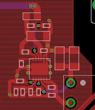

    Please also share the layout. That may be causing issues as well.

    Please attach your schematic and layout. I know your said the schematic is the same as the reference design but I want to double check. And the layout can cause noise which may hurt performance.

    And then the Layout:
    With the Ground plane layer:
    My colleague which design the board said me all datasheet recomandation was not respected.
    So he design a new board to patch on the old board, He try to respect the datasheet recommandation.
    By this we will validate or not if the problem us due to a bad PCB.
    PLease, could you check if new PCB seems Ok for you?:
    We think we could test it on the next week.

    Layout: Please also share the secondary-side layout. The original primary-side layout looks okay except for the lack of ground plane on the top layer. The new layout looks better. You can rotate the top enable resistor to connect to VIN without a via and you may be able to rotate the RON resistor to do the same (with the EN trace going under the RON resistor)

    I'm back to you after try our "PCB patch".
    We always get problem with the patch.
    So I compare the RFB1 and RFB2 value given into datasheet and the application note we were used.
    On the application note, RFB are about 86K and 20k where into datasheet, chapter 8.2.1.2.2FeedbackResistorDivider, RFB are 2k and 3k. Not atatch on the ratio value, because it depends of our wanted Vpri, but on the total resistor. About 100k in our case where the datasheet are about 5k. But it is written;
    Higher or lower values can be used as long as a ratio of the 3:2 is maintained.
    Then I try change Rfb from 86k/20k to 8.2k/2k. The ratio is aproximatively the same, but total resistor is 10 times less.
    With that, we resolve problem when Input voltage decrease under 16V and increase again. Output always restart correctly after many many try.

  • A GIR,
    I'm glad you have found ways to reduce the occurrence of the issue!
    Changing the resistor values makes me think the issue has something to do with the ripple emulation/injection circuitry (Rr, Cr, and Cac in TIDU670). Smaller resistor values means the injection circuitry has a smaller effect on FB. This makes sense because we've seen some switch waveforms which don't look perfectly stable. We've seen some runt pulses and unstable frequencies. If reducing the resistor values helped, I'm thinking we may be injecting too much into the FB node. You can try reducing the value of Cac or increasing the value of Rr to further adjust this subsystem.
    I think the ground plane on the patched newer layout helped. A solid GND plane is useful when dealing with issues like instability from the voltage on FB. It's optimal if the GND is moving as little as possible.
