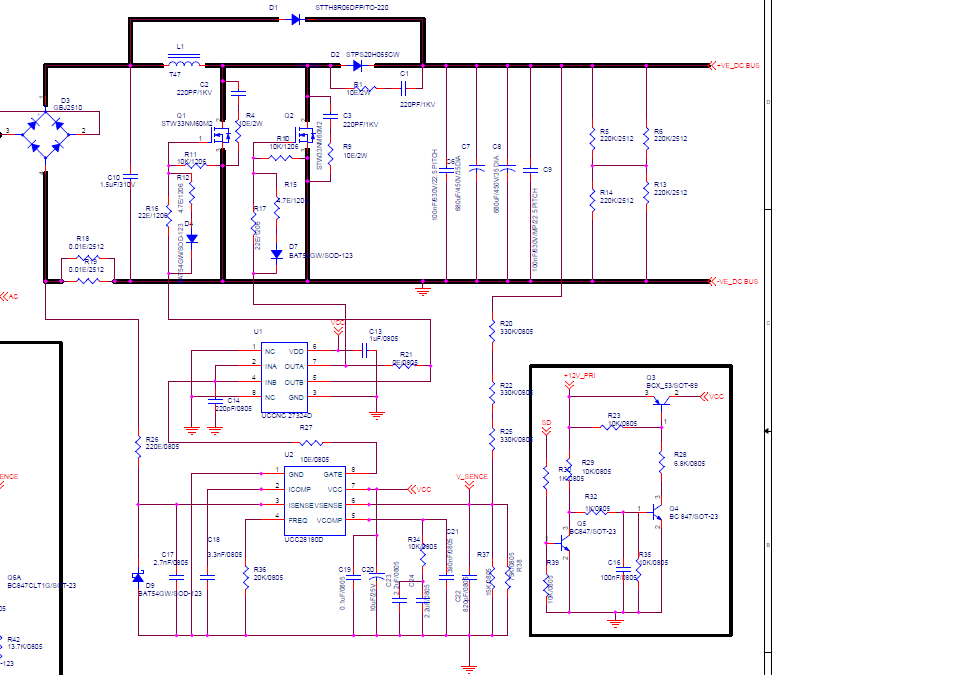

Dear sir,
Please help us to resolve issue.
Here the design details below.
We are designed PFC for 2.4KW
  • Input voltage range :150V-275VAC(50Hz)
  • Output:400V@6A
  • Operating frequency:100KHz
  • Input UVLO:85V
  • Power factor:0.99
  • Peak efficiency:98%
  • Operation temperature:Room Temperature 25°C(With air flow)
  • Auxiliary Voltage:12V
Design output details
  • L:117uH
  • Cin:1.5uF
  • Cout:680uFx2
  • Mosfet:STW33N60M2
  • Diode:STPSC20H065CW
  • Isense C:1nF
  • Isense R:0.005E
  • Icomp:2.2nF
  • Vcomp:C2:4.7uF, C1:470nF, R1:18K
  • Vsense:1nF
Schematic
Facing issues
  • Initial we are faced with output voltage fluctuation at input voltage 85V, 150V, 230V. at 230V DUT was got failed(Mosfets)
  • at above condition we placed 0.05E instated of 0.005E mistakenly.
  • Again DUT was failed after right shunt value placed, at AC 50V(we are increasing AC voltage from 0V to 230VAC)
  • we test with changing of Vcomp also but not solved.
  • And We are also tested with 3.5KW reference design values but DUT was failing continuously.
