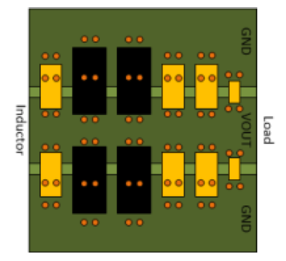

Our Analog front end is very sensitive to noise on some supplies. What is the best combination of caps given the 1500uF max  and with only one Polymer cap allowed and could use some advice on how to interpret this requirement.   We in general don’t have high requirements to transient behavior as the load is rather steady, but are concerned with dampening the switching harmonics.

    2) Lay out your capacitors as pictured below - with VOUT in the middle and GND along the outside.
    Please let me know if you have any further questions.
