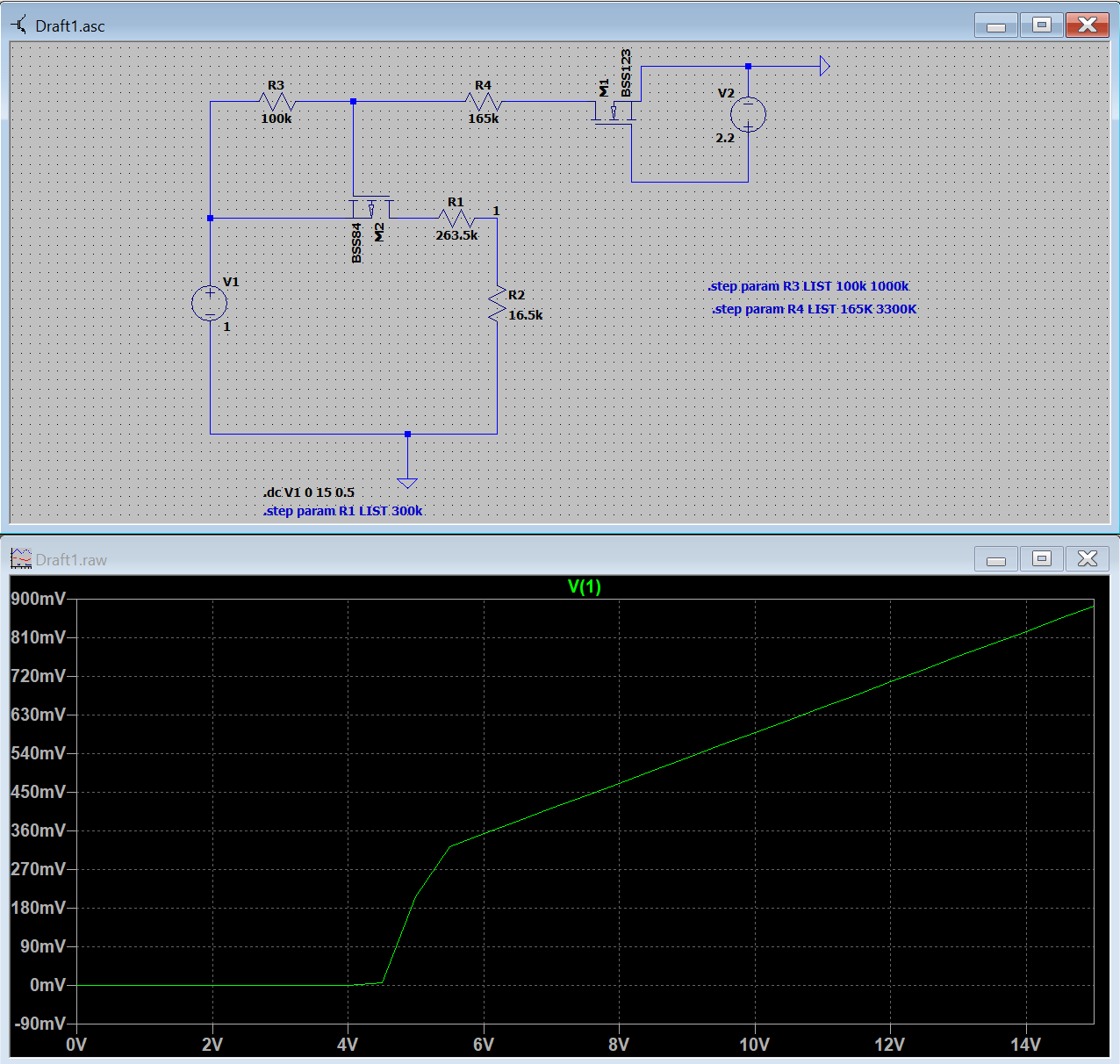

after my EVM seems to be broken (another case is open) I decided to use the real board with the BQ34Z100. But this is more worse than the EVM. I can't manage to get the voltage to the real meassured voltage (It shows f.e. 200 mV and meassured it's 10 Volt. And yes, the VoltSel is 1) . Therefore I am guessing, that the engineer maybe made some mistake in the design?
I am not sure if the Ground under the R40 is okay, and I think the R35 and R36 are way to high?

  • Hi Benjamin,
    R35+R36 should be calculated so the max battery voltage will apply ~1V to the BAT pin.
    Everything else looks ok.

    something is still going wrong and therefor I have tried to compare the Datasheet BQ34Z100 Page 32 Multi-Cell and 5-LED Display and the board design from our engineering. These are the main difference I have found and would like to clarify if it is still ok:
    (BTW. R35 and R36 on our Board, they now have around 236kOhm so the bat can go up to 15275 mV which is more than enough)
    BQ34z100 page 32 our Board
    R2 100K R32 1 M
    R4 165K R33 3.3M
    Q5 BSS84 Q2 ZXMP10A13FTA
    U2 SRN goes to Pack- U7 SRN goes to GND
    U2 SRP goes to Bat-/AGND/GND
    U7 SRP goes to Bat-
    So my questions are:
    1. What's the difference between AGND and GND?
    2. Can it be the same as on our board?
    3. Die the engineer mixed up the SRN and SRP? Or something with the GND?
    4. And regards a LTSpice Simulation it seems to be very different between the BSS84 (Q5) and the ZXMP10A13FTA.
      Is it advisable to have the massive drop (picture 1, "copied from manual", if the BAT+ gets too low? Or is the 2nd picture (from our board) better because it linear?
      2nd picture:

    And I would like to know if this can have an impact on my drop. In this picture I can see that the Ground here is directly connected with the Bat- and is also the ground for the voltage devider and the VSS. On our design the Ground is not connected with the bat- but instead with the SRN PIN, which should only be for the load/charge?
  • Hello Benjamin,
    You should follow the reference schematic for the EVM, just eliminate the sections you don't need (configurable voltage dividers, alert, etc)
    The ground should not be tied to SRN, it should be tied to what's shown on the schematic (SRP, BAT-) Have you been testing on an EVM as well? Are you still seeing these issues with the EVM and your battery pack?

    the picture in the initial post (the first post in this thread) you can see our board design for the Gauge. So it looks like many parts where not build in.
    Just to clarify the part "ground should not be tied to SRN" (and yes we live in germany :) ) The ground MUST be tied to the SRP? Then I can send this info to our outsourced engineer department for not doing the design correctly.

  • Hello Benjamin,
    Yes, just make sure the grounding follows the EVM example. Ground should be on SRP.
