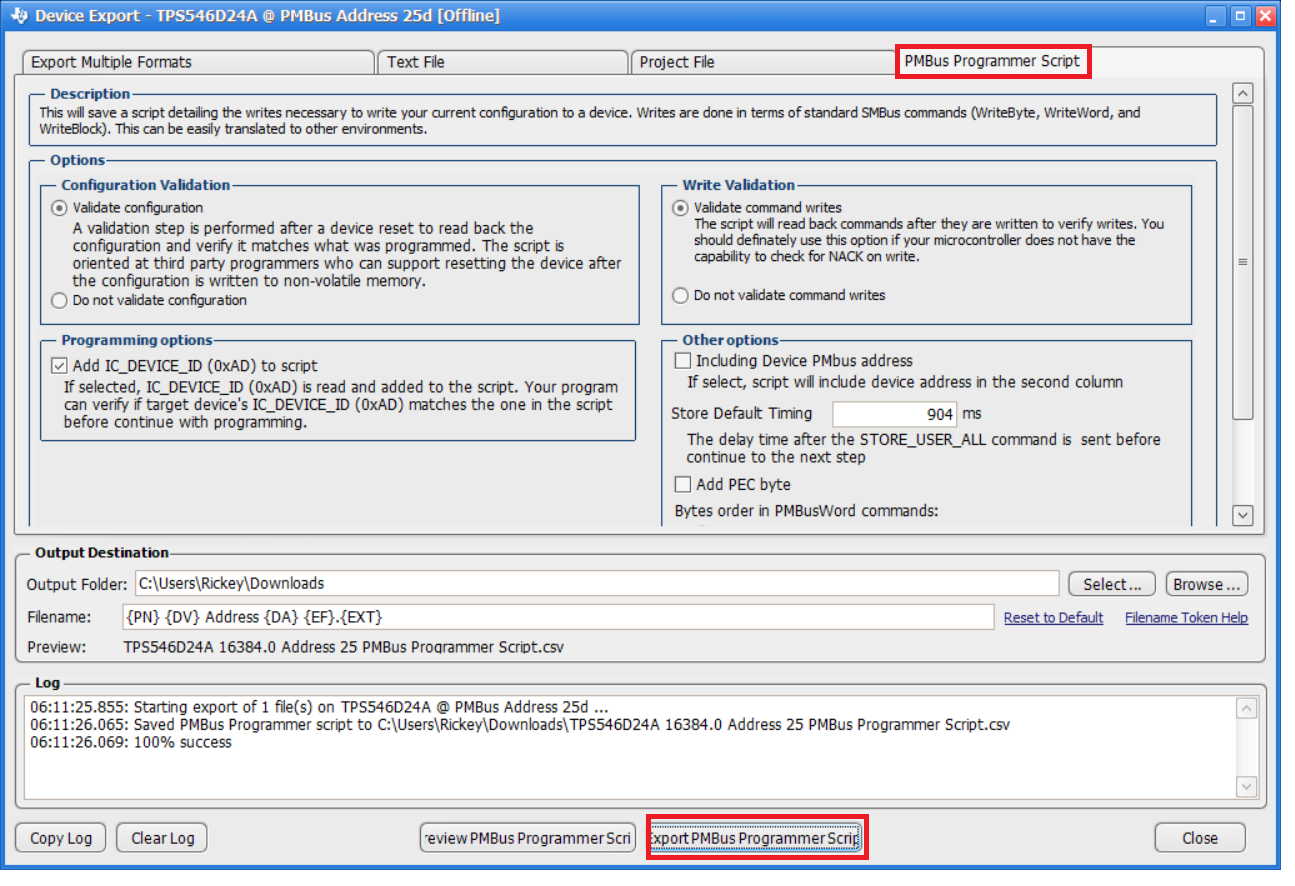

We are the off-line programmer manufacturer and for the previous TI TPS devices. We can get the CSV file which exported from "Fusion Digital Power Designer" to understand how the program the TPS device. Can you advise how to export or transfer the .json(project file) on IPGUI to CSV file?

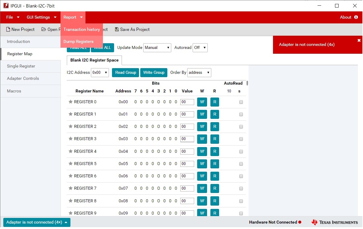

    You would need to connect the BOOSTXL-TPS65218 + MSP430 LaunchPad (or TPS65218EVM-100 + USB2ANY) to your laptop running the IPG-UI software.
    When the software is connected to the PMIC you can do a Register Dump to get a .txt/.csv file of the register map that is currently stored in the device.
    There is not a direct method to turn a .json file into a .csv file without the hardware connected.
  • Hi Brian,
    Thanks for your reply. I can find the dump registers function in the IPGUI but it's the register and value in txt format only.
    Can you advise how to export the CSV file? (Just like the CSV file which export by Fusion Power Designer)?

  • Ricky,
    The text file is formatted as tab-delimited (instead of comma-separated) and this is easy to view in a smart text editor, like NotePad++ or Sublime or Atom.
    You can also open .txt file in Excel and re-save as .csv if you want. When you open .txt in Excel, you can select the following options to get 2 columns (column 1 = Register Address, column 2 = Data Value)

    Thanks for your reply. The TI fusion power design GUI can export the programmer script file as CSV file format.
    The programmer will extract the write/read command/data from the script to do the off-line device programming.
    This txt file has command but only register/value.
    Can you advise is there any function to export the programmer script just like Fusion Power Designer?

    TPS546D24A 16384.0 Address 25 PMBus Programmer Script.csv
  • Fusion Power GUI and IPG-UI are not related. Fusion Power GUI is for PMBus and they have script for generating CSV.
    IPG-UI is for I2C and performs register dump with .txt file.
