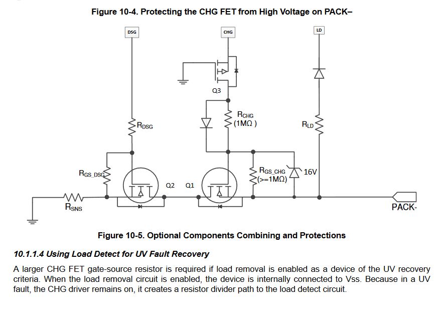

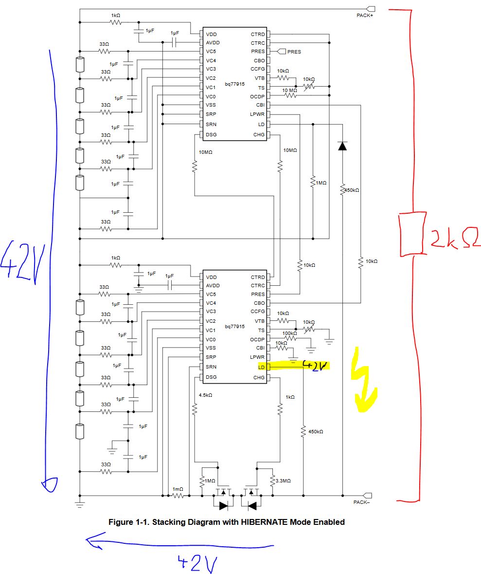

In a stacked arrangement of 2x bq77915 with low-sided mosfets, UV loafd detection, battery voltage of 42V (10s @ OV 4,2V) and a load like 2k resistor is connected.
Everytime any protection trips and one or both mosfets cut of, PACK- Pin get near PACK+ pin. Further I have 42V on LD Pin. The absolut maximum ratings says MAX 20V are allowed.
Do i have a fundamental understanding mistake? Probably someone can clarfy me.
