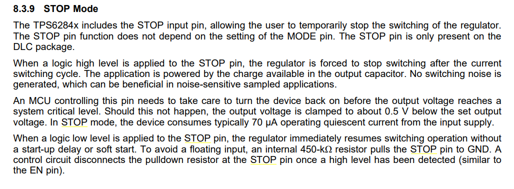

Team, I would like to know the state (high impedance, high, low) of the SW pins when either the EN or RUN/STOP signals are activated. The idea is to use one of those pins to disconnect the tps62840 from the rest of the circuitry in the production bench. I would assume that both the P and N FETs are off (when EN is active) and thereby leaving that pin with an high impedance state.

    2. Instead, during STOP mode, the device output is clamped at a value equal to: Vout - 0.5V.  Again, referring to the datasheet:
    In order to achieve this clamping, the high side Mosfet is not OFF (it draws a small current to keep the output from discharging completely).
    To sum up, neither of these configurations set the SW node to an high impedance state.
