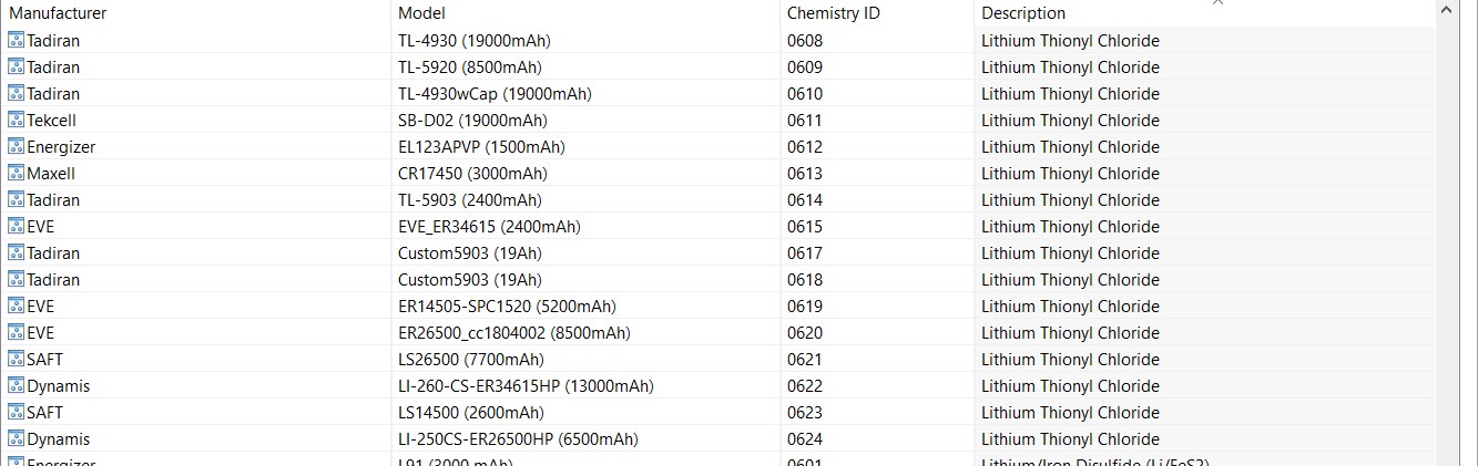

we are using BQ35100 and we need to select the right chem-ID for our battery.
unfortunatley we can't find it in the suggested list.
We use ER2450 Li-SOCl2 battery with approx. 550mAh capacity.
Tadiran's TLH-2450/P could be used as reference but it's not available in the list.
any suggestion?
thansk a lot in advance
KR
Vincenzo
  • Hello Vincenzo,
    Make sure the chemistry ID data base is the most updated version, we update the data base often.
    If the battery is not in the chemistry ID data base then we would need to characterize it. We can take it offline to coordinate making a new ID.
