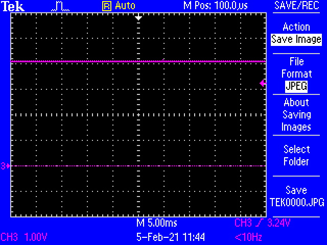

  • Well I think we have some improvement but still have a bit of confusion.
    1) Here are the images of the various wave-forms
    this is VBATT
    This is the power supply that is imitating  the solar panel input
    This is the Boost node after the input inductor
    VDIV
    VSTOR
    So now things are moving along but the output signal to turn on the P-FET is still high
    Per the suggestion on high value resistances I lowered all the sense resistors by a factor of of 100 and things seemed to be functioning although the output from the solar cell input would drive the BATT to 6.25 volts when the input to the battery was driven by a lab power supply (single quadrant type ie no ability to sink current).

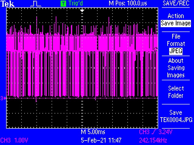

    Turning off the Solar input power supply and replacing the (Battery) lab power supply with an actual Li-Ion battery we get this waveform on the VSTOR line
    If I turn on the Solar input power supply it appears that everything starts working again with VSTOR going just a few mV above the battery terminal voltage and it seems to be charging the battery as expected.  I can remove the Solar in voltage and it appears that the system stays running unless a remove and reattach the battery?

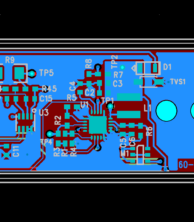

    Regarding the 6.25V, that is bad.  The output can't withstand more than 6V.  The other known issue is noise into VSTOR that is not getting filter by the 0.01 or 0.1uF capacitor from VSTOR to GND.  This noise can also cause a problem with the VSTOR regulation.  That capacitor must be as close to IC as possible as shown in datasheet layout example.

  • I do understand this is a boost only converter and the input voltage is less that battery voltage and seems to do it job just fine as depicted in image 3 above.
    Here is a picture of the layout. The caps are right there as close as is practical  Resistors and Caps are 0603. C5 and C6 are the capacitors in question
    My biggest concern now is the failure to start with only a charged battery and the VSTOR waveform at about 1 volt and a 1 Second period. as shown in imagee 5 above. Once I power the unit from the "solar in" the output of VSTOR seems to come back to battery voltage and the nVB_SEC_ON will go low. I can remove the MPPT input and the unit appears to continue to work. If I remove the battery however the voltage rises to over 6 volts.

    If I understand correctly, nVB_SEC_ON is working correctly now?  But VBAT_OV is still too high.  The only 2 know issues for the charger to be out of regulation are the 1) the parasitic resistors formed by solder flux, which you mitigated with smaller valued resistors and 2) the placement of the 0.1uF capacitor to filter out switching noise, which you placed correctly.  The pulse waveforms are showing VSTOR = 4.05V and 2/3*VBAT=2.7V, which are within tolerances.
    When you insert a charged battery, the VSTOR and VBAT_SEC voltages need to be close <100mV.  If not, the PFET between VSTOR and VBAT_SEC will not close until the input charges up VSTOR above 2.0V.   The charger is in cold start until then so charging up the VSTOR cap may take some time.
    Regarding the rise to 6V with no battery, is the boost converter still switching at LBOOST and trying regulate to 6V or this is simply an overshoot due to only 10uF at VSTOR?  If only overshoot, adding more capacitance at VSTOR should prevent the overshoot.
