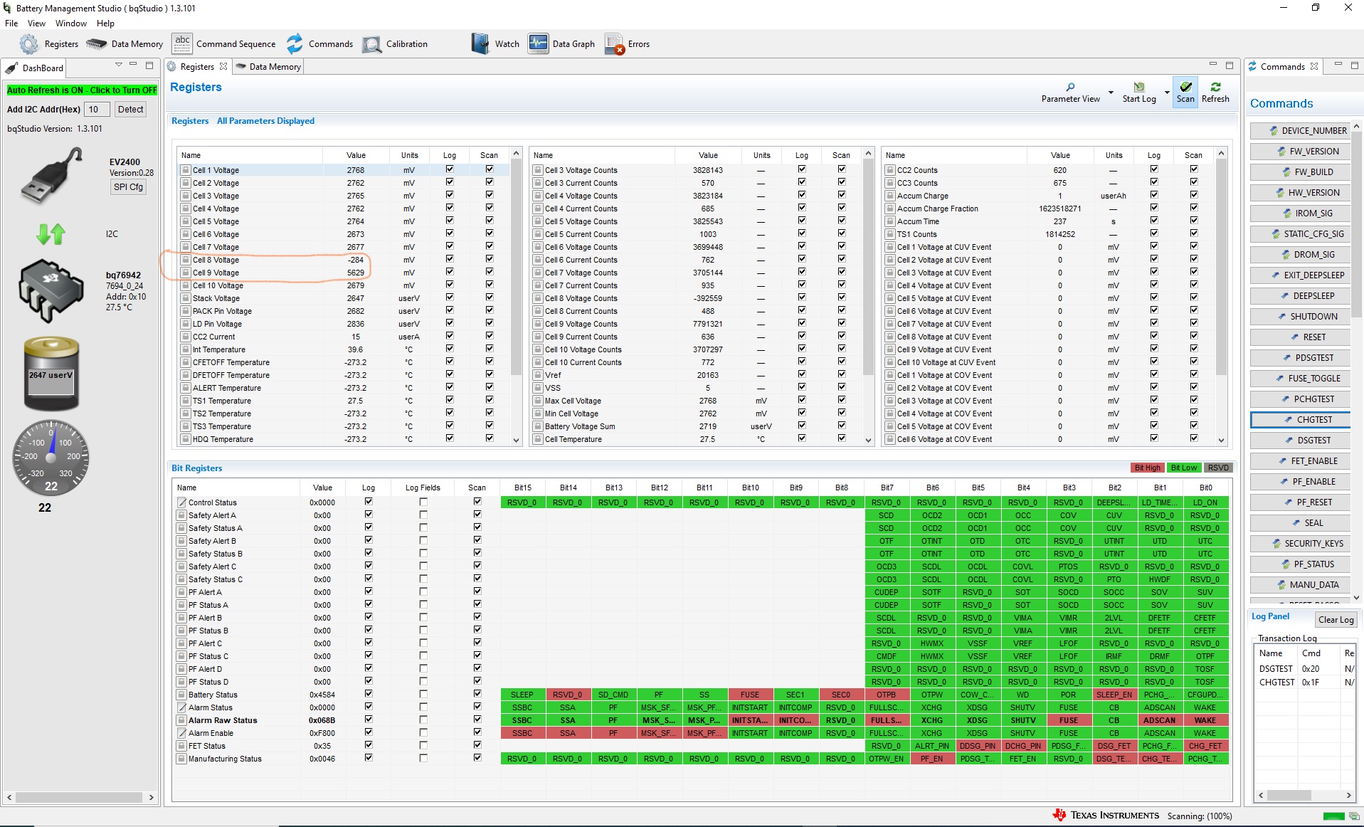

My problem is when I used the Cell simulator(or using jumper setting) between Cell1-Cell10 (between BAT- to BAT+).
when we remove any one jumper to make voltage not equal between two conjunctive cell(Cell8 or Cell9) , the voltage appears on cell8 voltage and cell9 voltage is given and marked on the screen shot attached with this thread in more details. please refer "Register.jpg" file.
if the difference between Cell 8 and cell 9 is not as per our setting, then why the DSG and CGH MOSFET is getting on/off by using DSGTEST/CHGTEST command by GUI(Battery Management Studio) while voltage between these two sell is not as per actual settings?
however in actual way in that condition either DSG/CHG MOSFET should not getting in ON condition. it should be in OFF condition .
so what setting/Register settings, I need to do to getting automatically DSG/CHG MOSFET will get OFF when this condition will encountered?
Note:- Same things happens in case of actual battery connection when one cell voltage is far below than all others cells.

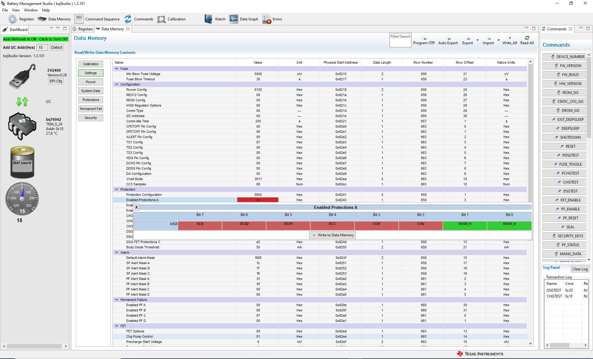

OUR Register Settings:- I have settings the bellow Registers setting to manage this conditions

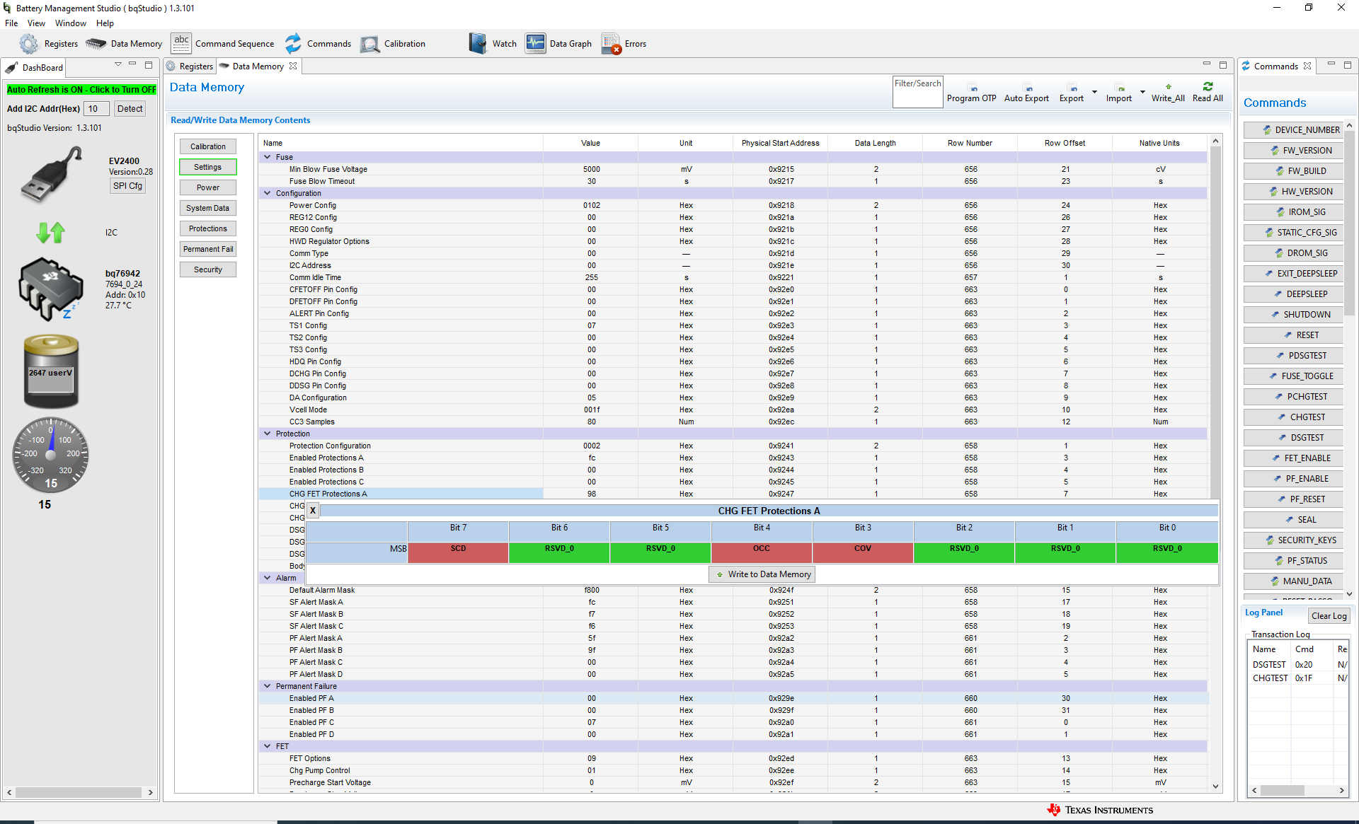

1. Data Memory-->>Settings-->>Protection-->>Enabled Protections A

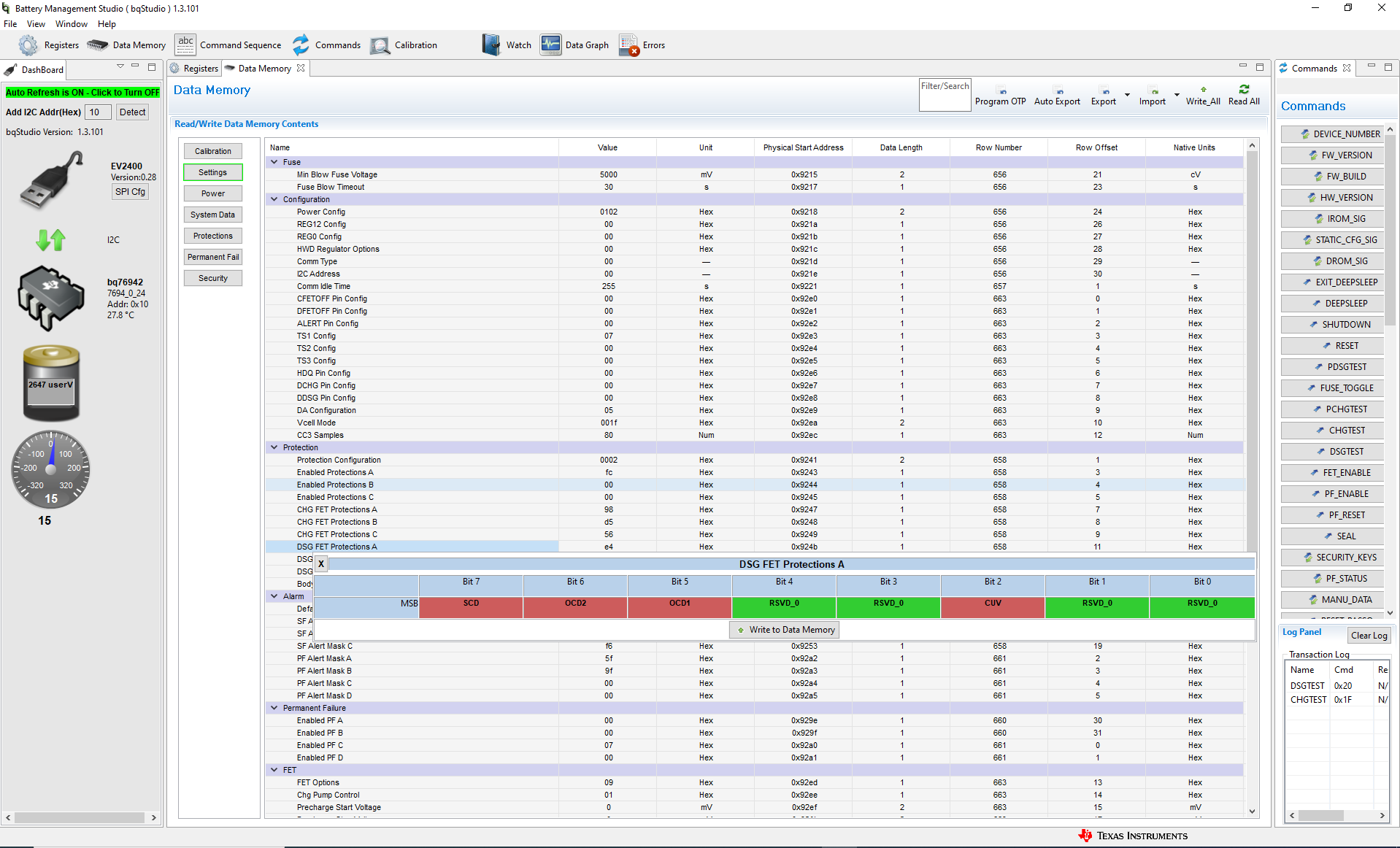

2. Data Memory-->>Settings-->>Protection-->>CHG FET Protections A
3.  Data Memory-->>Settings-->>Protection-->>DSG FET Protections A
4. Data Memory-->>Protections: CUV [Threshold, Delay, Recovery hyst]
                                                    COV [Threshold, Delay, Recovery hyst]
Please see the all above details is screen shot attached with this thread.

    In the Manufacturing Status register, FET_EN is not set, so the part does not have control of the FETs.   The FETs are on due to the CHGTEST and DSGTEST commands as shown in the register and resulting in the FET Status register value.
    A person would expect the high and low voltage set on cells 9 and 8 to cause an OV and UV faults.  However the Settings:Configuration:Vcell mode value is 0x001F, so only the bottom 5 cells are set as used cells to be considered for the protection decisions.  Cells 8 and 9 are not used for the fault determination.  See the technical reference manual section 4.1.2
    Set the Vcell mode to 0x03FF for 10 cells.
