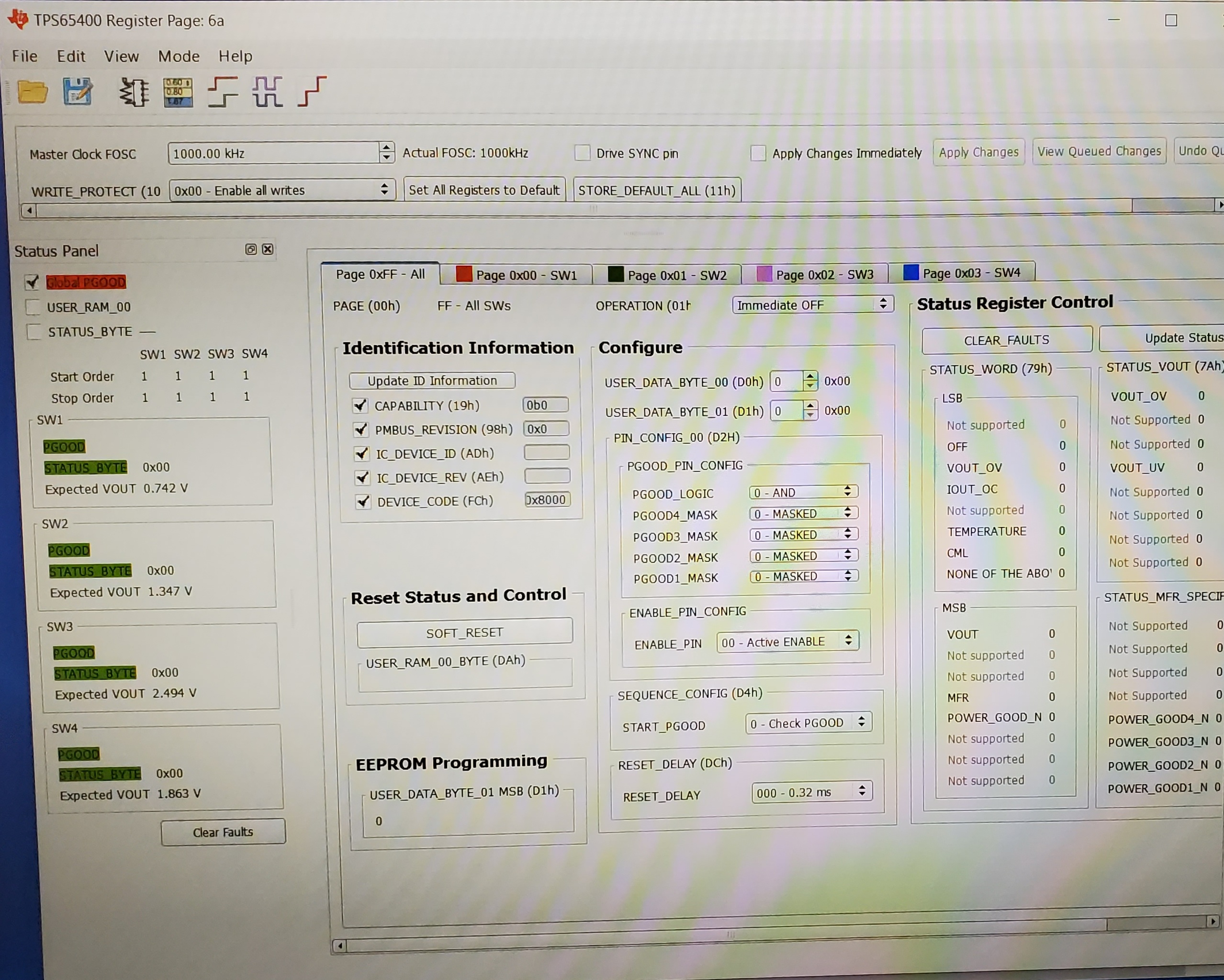

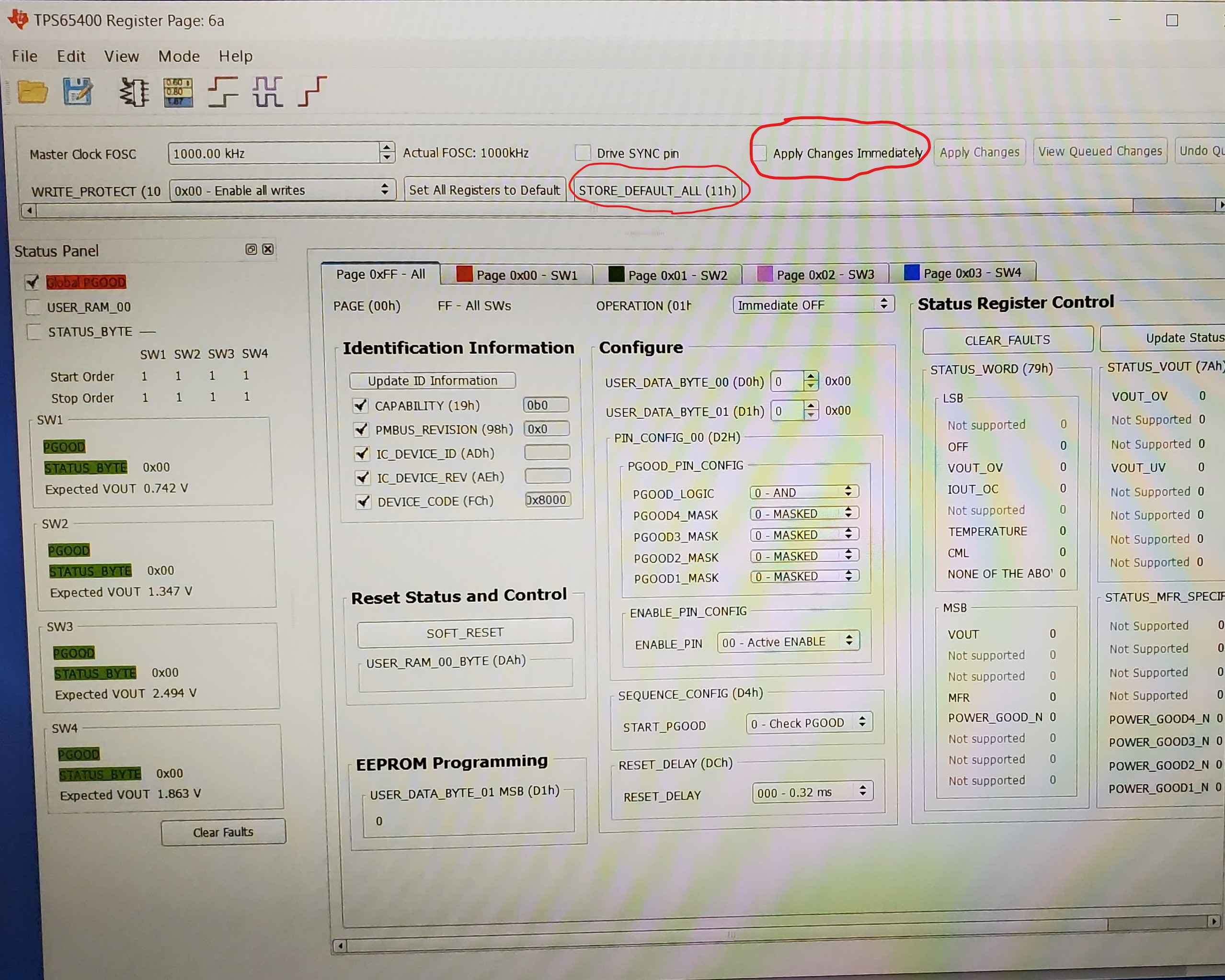

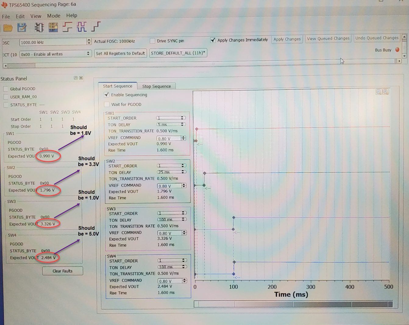

  I currently have a PCB with a TPS65400 part, and EVM software recognizes the part.  However, it does not control voltage output sequence or provide correct voltage output status.  Can you please help to figure out why this is happening?
