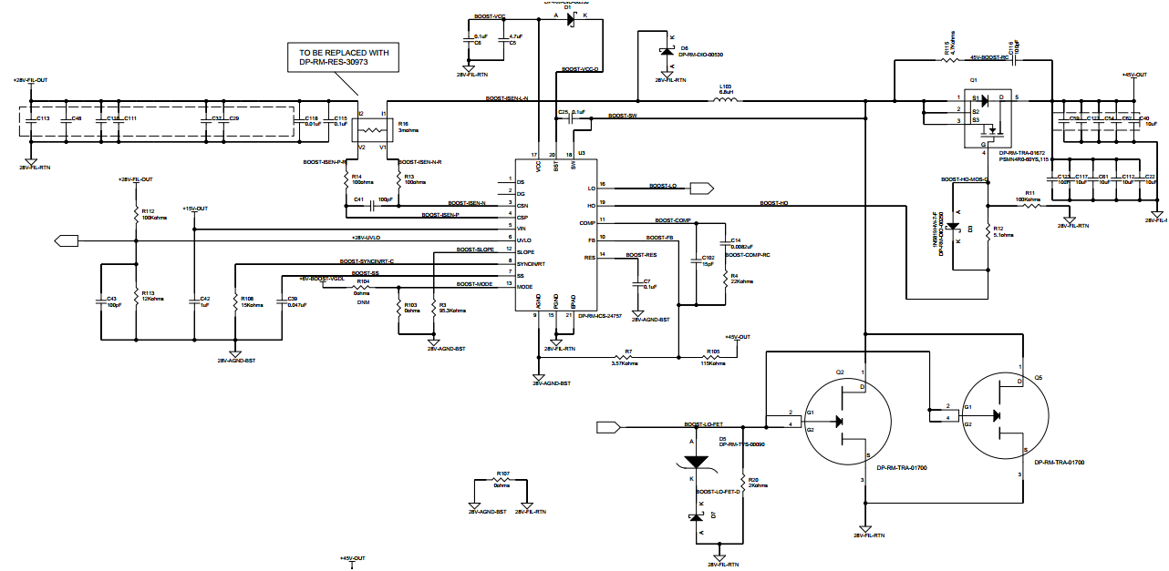

We are using LM5121- Synchronous Boost converter in one of our application.
Details On converter design are given below.
Input Voltage : 16V to 36V (Capable to source Maximum of 30A)
Output voltage : 40V / 9A
Switching Frequency : 600KHz.
LO FET was driven by gate driver IC UCC21520ADW. Since it's Vgs should not go above 7V.
Below are the testing observation:
3V UVLO voltage, 7.6V VCC pin voltage and DG to DS voltage was 15V.
We get a output voltage which follows the dropout of input voltage. Power switching not happened.
Please go through the below schematic, and provide feedback if any issue is there?
