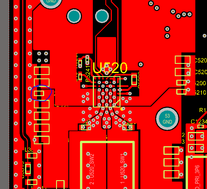

  • Thanks for the quick reply, Jeff. I've attached a view of the layout. The 0.47uF cap is circled in blue.
    Grounding TS was intentional - I wanted to prevent charging at startup until the microcontroller is running, so it sets the IGNORE_TS bit when it's ready.
    I will try changing the 0.47uF cap. I don't remember why I used that value.
    ILIM_HIZ was tied to REGN just for layout. I'm not using microvias, so some pins are not accessible. I did verify that it worked on the eval board, and I don't need the pin function, since the microcontroller is always setting up for charge.

  • I added a 0.1uF cap from VSYS to GND on the backside of the board, directly under the BQ part. This also made no difference.
  • Jim,
    The 0.1uF capacitors are too far away from the IC to filter high frequency switching noise.  So, I can't rule out that layout as the issue.  Furthermore, the only layout we have tested is the BQ25790EVM layout with the SYS and PMID capacitors as close as possible to the IC.
    The charge SYS_SHORT feature is explained below:
    When the SYS voltage falls below 2.2 V, the charger immediately enters the PFM operation, to limit the output current to approximately 1A or less (regardless of the DIS_VSYS_SHORT bit setting). If the hiccup mode for SYS short is enabled by setting DIS_VSYS_SHORT = 0, the charger shuts down when the SYS voltage drops below 2.2 V longer than 10ms. After waiting for 500 ms, the charger attempts to restart the converter. After 10 ms of converter operation, if the SYS voltage is still lower than 2.2 V, the charger shuts down the converter for another 500 ms and the cycle repeats. After 90 s from the first short detection, if the converter shuts down for 7 times, the charger latches off the converter by setting the EN_HIZ bit to 1. If the VSYS_SHORT_MASK is low, the device also asserts an INT pulse is asserted to alert the host, the VSYS_SHORT_FLAG fault register gets set. The latch off is cleared when EN_HIZ bit is set to 0. If the system voltage is still lower than 2.2 V when the host clears the latch off, the charger enters the hiccup protection again. If the hiccup mode for system short is disabled by setting DIS_VSYS_SHORT = 1, the converter continues running in forced PFM operation when the SYS voltage is lower than 2.2 V. After 10 ms deglitch time, an INT pulse is asserted to alert the host if VSYS_SHORT_MASK is low, the VSYS_SHORT_STAT and VSYS_SHORT_FLAG fault registers get set.
    Are you certain that you input current limit setting and input power is high enough for the load on SYS at start up (keeping in mind that discharged capacitors look like shorts to GND)?  I can look at scope plots if you think it will help.  I would need to see VBUS, IBUS, SYS and ISYS if possible.
    Jeff

  • Hi Jim,
    As I previously mentioned, it could be switching noise spikes that are not getting filtered by the placement of the capacitors.  We initially found similar faults until we placed the 0.1uF capacitors on SYS and PMID as close to IC as possible on the EVM.
    Can you scrape off solder etch and move those 0.1uF capacitors closer to the IC?
    Jeff
  • There isn't any GND on the top side. I did add a 0.1 cap on the bottom side directly under the chip on VSYS. I can add another for PMID and try it, but it still seems odd that there would be a switching noise issue when no switching has occurred.
    Can you confirm that you saw the same behavior (i.e. switcher never starts) before you moved the caps? Or did it see the VSYS short condition only after the switcher started?
    EDIT: Actually, GND is accessible on the top layer right in front of the chip where your eval board caps are. I will try to add caps there.

  • Jeff,
    I have the eval board for both BQ25790 and BQ25792. I see that you made the cap paths much shorter on the 790 board than on the 792 board (~10mm). Were there problems with the 792 eval board? I will be moving those caps on my next layout rev, and I would like to know how your two layouts compare.
    Certainly the 790 layout is the ideal, but I'm wondering how close to that I need to be. I kept the SW1 and SW2 paths on the top layer and those have to go underground to duplicate your 790 cap locations.
  • Hi Jim,
    The 790 layout pic above is correct.  It is the final board layout.  When we first got back silicon we didn't install the 0.1uF capacitors and saw various false faults.
    The 792 layout above is the pre-release EVM.  Even on that EVM, in order to prevent the false faults, i had to flip those 2 0.1uF capacitors 180 degrees and run a small wire down the middle ground pin.  The final EVM layout, updated in the latest EVM user's guide online, is different as shown below:
    Jeff
  • OK. I think my added caps are very close to that layout. I will do it ideally on the next layout.
