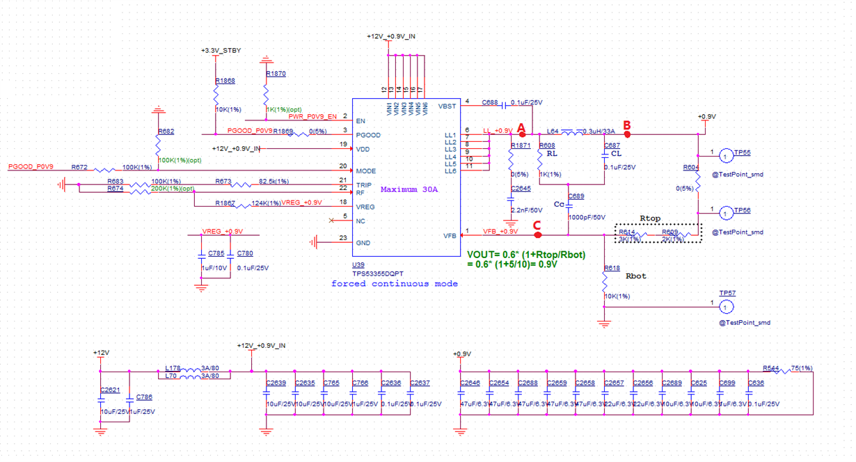

we meet a issue for TPS53355 design, refer to below pic for sch.  the snubber circuit R1871=0,C2645=2.2nF.

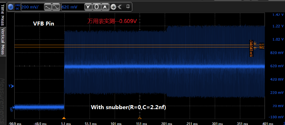

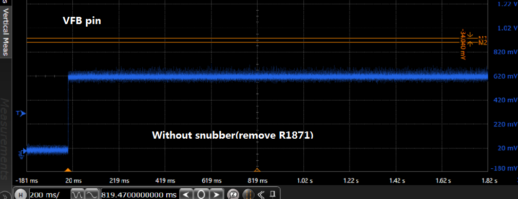

we test the waveform on the VFB pin(Point C) with and without snubber(remove R1871) separately.
we find the snubber will affect the VFB waveform largely.
Is it normal ? and how the snubber affect VFB ?

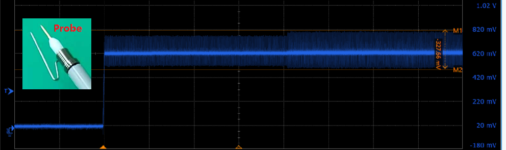

    1) Check Probe measurements.
    I test the VFB signal by the Keysight N2870A  probe (1:1 passive, 1MΩ input, 35M bandwidth) with ground spring, and only use one oscilloscope channel, and we re-test it by limit the bandwidth to 20M, it seems the case with the snubber still is abnormal.

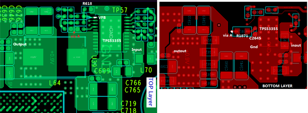

    the layout refer to below pic, i already mark out the snubber RC /DC output /DC input location, there is a via A that connect the top layer LL to the bottom layer snubber circuit, it looks workable. please help check if the layout will cause this issue.

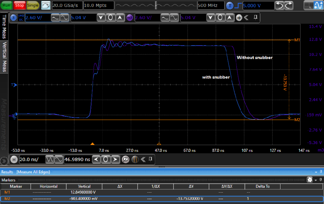

    i also test the LL with/without Rsnubber 0ohm, it seems the waveforms of  LL  are similar with/without snubber .
  • Thank you very much for sharing.  Looking at the switching node, we see a 170MHz switching node ringing.  With a 35MHz bandwidth probe, it's not surprising we do not see much shift going from 35MHz bandwidth to 20MHz bandwidth, though it's hard to infer much about the switching node from a 35MHz bandwidth limited measurement.
    There does not appear to be much frequency shift between with a snubber and without, which makes me question if the inductance from the single via pass-through is limiting the effectiveness of the snubber   WIth little improvement in the 170MHz ringing, the snubber may not be necessary, though I would recommend a higher-frequency probe is one is available.
    The layout looks pretty good, but I would recommend using the same oscilloscope probe to measure the ground voltage near the Vfb pin with and without the snubber, just in case there is an "Earth Ground" connection on the board somewhere that  is inducting a ground current through the oscilloscope  probe.

    The regulated voltage at the FB pin should be 0.6V.  With your 10k resistor from FB to GND and 5k resistor from FB to VOUT, the converter should regulate to 0.9V regardless of the date code.
    1) Double check R609 and R614 to make sure they are 3k and 2k and not 2k and 2k, which would give a regulation voltage of 0.84V
    2) If the resistor values are correct, check the voltage at the FB pin, it should be 0.6V
    3) If the resistor values are correct and the FB pin is 0.6V with VOUT 0.85V, check C689 to make sure it isn't shorted out and conducting current into FB around R609 and R614.
