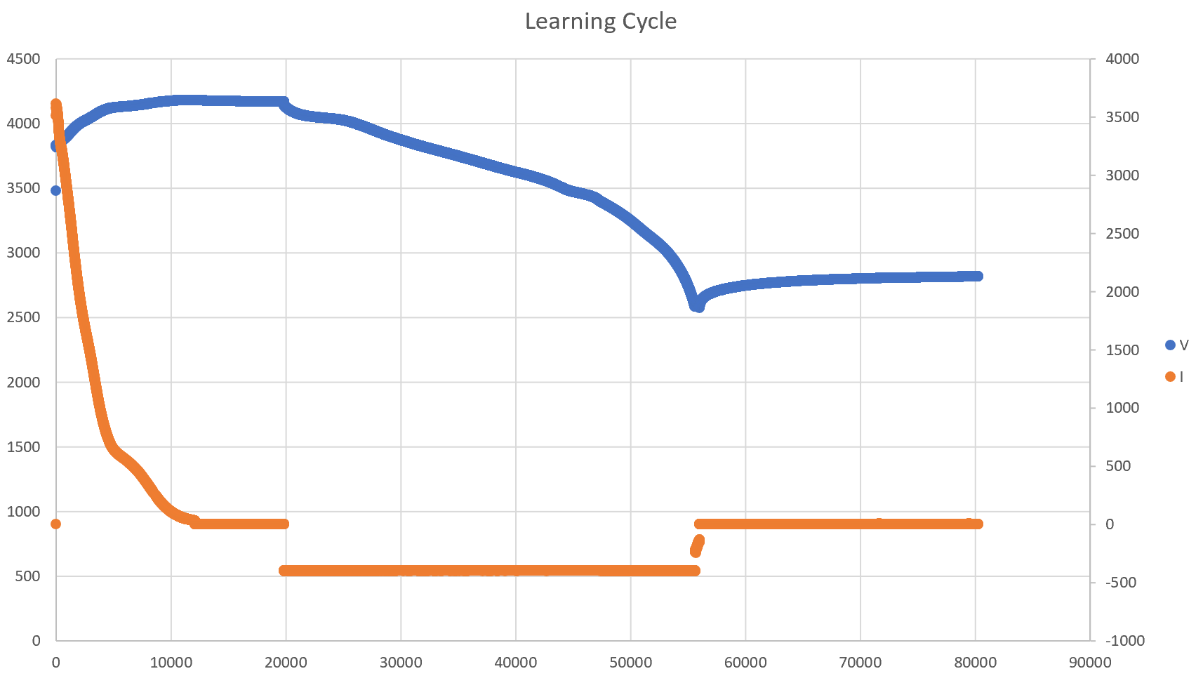

I then did a learning cycle, which finished properly and learned state 6 is achieved.

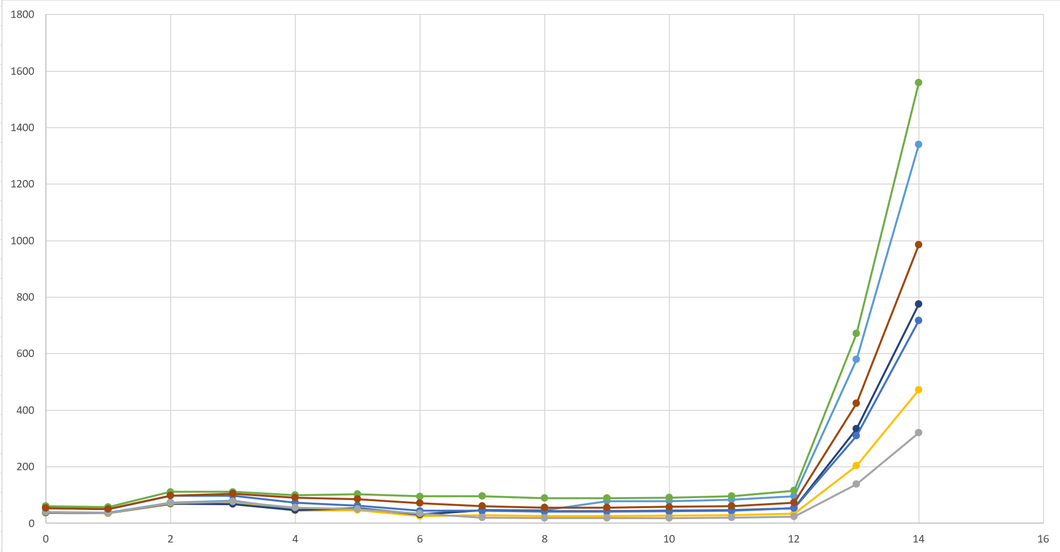

Also, I have been watching the Ra Tables and they seem to vary quite a bit between packs. Is this normal? See the attached plot:

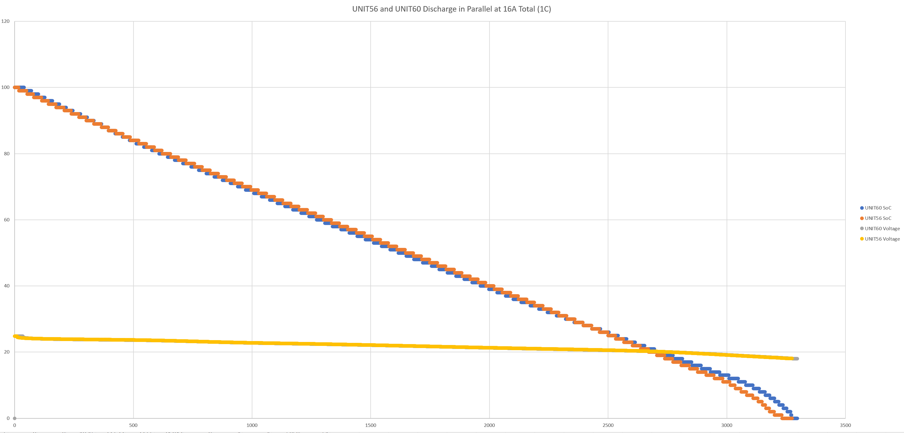

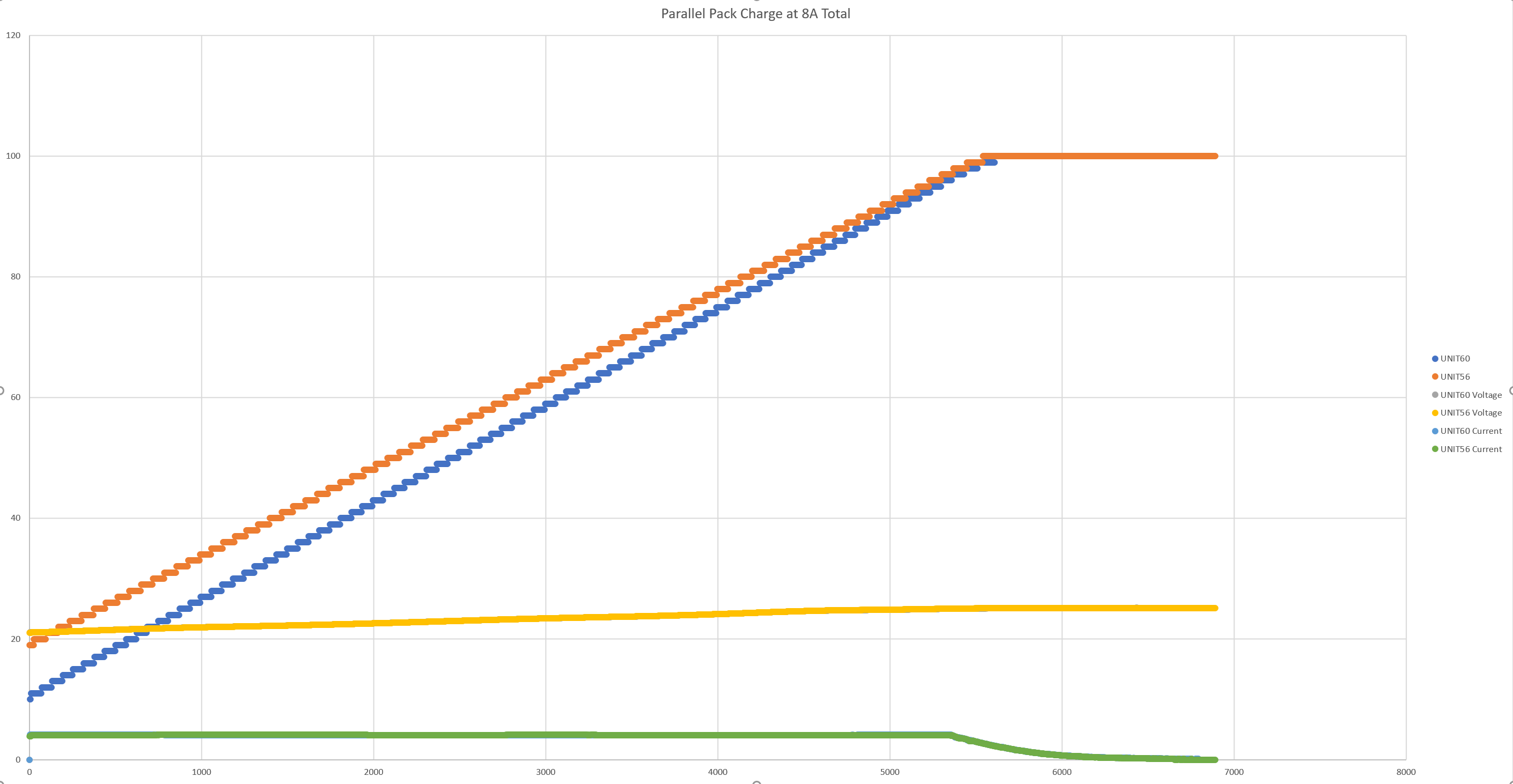

  • Here is an interesting plot of two batteries connected directly in parallel, discharging at 1C each, then charging together at C/2 each. Unfortunately I cutoff the lower portion of the graph during charge, but I think one was starting from around 9% SoC and one was zero. The interesting part was that they both discharged to 0% SoC right around the cutoff voltage of 18V (3V/cell) under load. After a period of relaxation, I noticed that they went up in SoC value after the OCVTAKEN bit was set, where one was about 7% and the other was 9%, then between the time that I checked this and when they started to charge, one of them had dropped back to 0%.
    In thinking about this and looking at the graph above of the Ra table values, it seems that as the impedance raises during the end of discharge the inaccuracy may grow and be correlated?

    1. My learning cycle was based on a graph that looks like this (for a single cell). Notice that I discharge all the way down to 2.6V or less, while my application only typically discharges to 3.0V. Is that a problem?

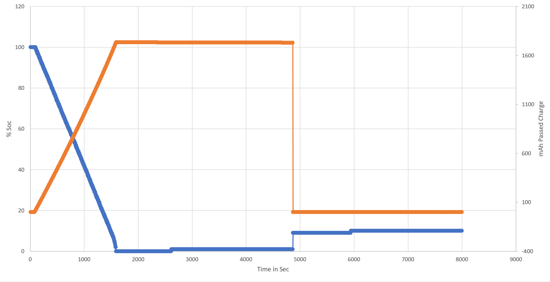

    2. Please see the following plot of the SoC vs passed charge while relaxing after discharge. The SoC jumps up to 9 after the state change, then raises up to 10 after that as well. Why is that? Is it because the algorithm starts factoring in the 0 current draw at that point and thinking that there is still 9% capacity if discharge is super slow? Can I change that so that it always assumes the value is going to be 2C by maybe setting the load select to 6 (user defined rate)?

    The cells will relax upward after discharge, the gauge then takes an OCV measurement during relax and the SOC is updated accordingly.
