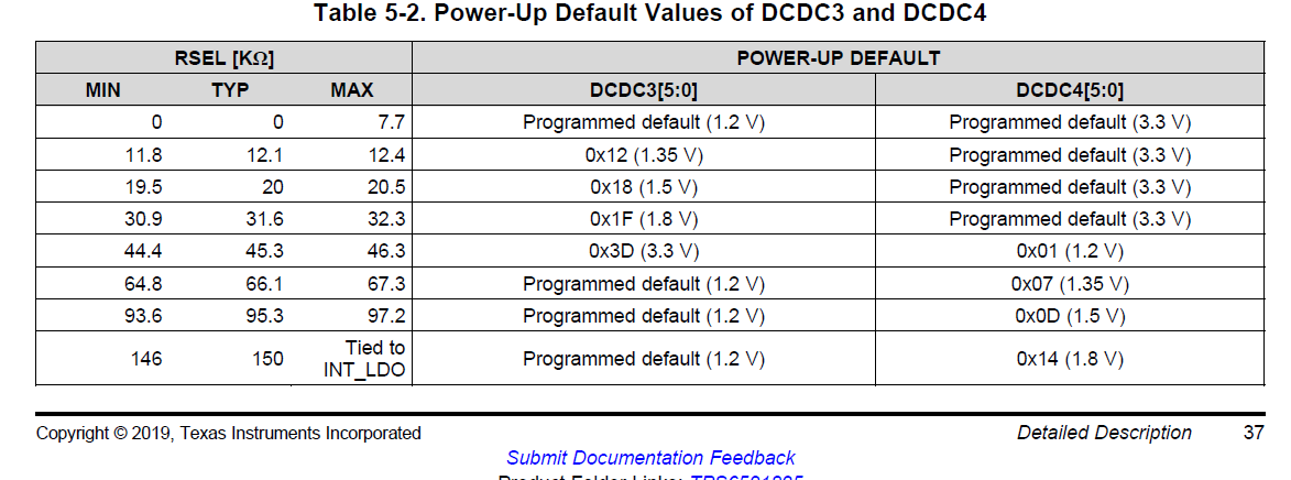

Which one is the TPS6521825 default ouput voltage?
a) DCDC3=3.3V, DCDC4=1.8V (for i.mx8mm)
b) DCDC3=1.2V, DCDC4=3.3V (datasheet table 5-2)
I am worried that the contents of the table below are different from the Device Overview.
We will used the TPS6521825 combination with LP873347RHDT for i.mx8mm.
And how many resistance values should i choose for DC34_SEL? pre-programmed=0?
  • If DC34_SEL = short to GND with 0-Ohm resistor, then DCDC3 = 3.3V, DCDC4 = 1.8V because the PMIC will boot with the following programmed default values in EEPROM:
    • Refer to Register 0x18 (DCDC3), bits [5..0]: Reset value = 0x3D = 3.3V (this is the programmed default value for TPS6521825)
    • Refer to Register 0x19 (DCDC4), bits [5..0]: Reset value = 0x14 = 1.8V (this is the programmed default value for TPS6521825)
    Ignore that is says DCDC3 = 1.2V, DCDC4 = 3.3V because these are only the programmed default values in the TPS65218D0 variant of the device. All other variants have different programming and will result in different output voltages when DC34_SEL = short to GND with 0-Ohm resistor.
