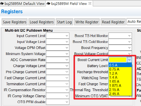

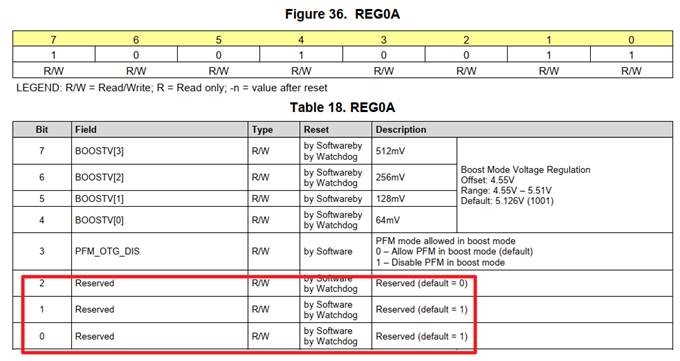

Dear Sir,
BQ25895M have Boost mode Current Limit Reg but it is reserved.
We can use to set other setting value or you have planning to release the register?
    For BQ25895M, the RBFET (Q1) is off during OTG mode. Only PMID is the OTG output So the boost current limit via Q1 does not work. If the boost current limit is needed, please use BQ25890 instead.
