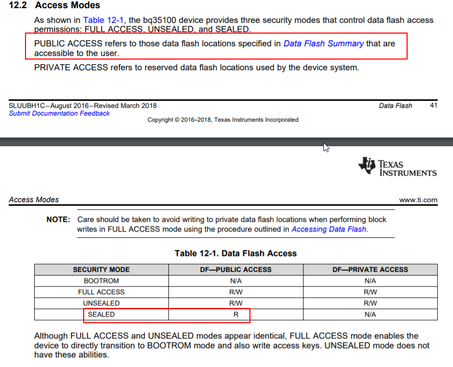

I would like to know, it's possible to read dataflash when i am in SEAL mode ? and if it's possible what are dataflash that i can read ?
If it's not possible, can you say me the registers that i can modified and i can read when i am in SEAL mode ? Because it's not clear for my, in Technical reference Manual (SLUUBH1C).
