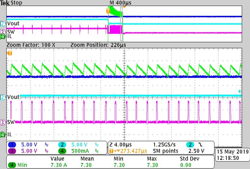

    Here I upload a OCP waveform of TPS56637 as attachment.
    Andrew

  • Hi Takashi-san,
    1. It's said in the datasheet that "hiccup time" is 25ms, I think which corresponds to the interval of hiccup pulse as you mentioned.
    2. The SW pulse stopped because the UV protection is triggered. When inductor current is larger than the OC set value, first the OCP will be triggered. During off-time in OCP, the low side Mos will keep turning on until the inductor current valley (sensed from voltage of low side Mos Rdson) equals to the set OC value. Then the on-time will start and it's fixed to a short time. And off-time will start again.. This kind of protection is the so-called "cycle by cycle" protection.
    With this kind of OCP, the inductor valley current is limited to OC value. Also the inductor current ripple will be certain value since the on-time is fixed. So the average inductor current is limited as certain value in the cycle by cycle OCP. Since the output current Iout>IL, the output cap will be discharged to provide the output current and the Vout will decrease. After the output voltage falls below 65% of set value, a deglitch timer will be triggered. If the under voltage situation last longer than 256us, then the UV protection will be triggered. During UV protection, SW is stopped. That also starts the hiccup process, converter will try to restart after 25ms hiccup time.
    3. If OC condition isn't removed after 25ms, converter will restart with OC loading, which is same as the procedure to power up with OC loading. During softstart time, IC will try to charge the output cap but the output voltage increase is limited due to the OC protection limit. After softstart time, the UV protection will be triggered. After 25ms, next hiccup restart will happen again.
    If there's anything unclear, please point it out and I'll try my best to give explanation.
    Andrew

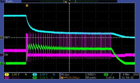

  • Hi Takashi-san,
    You can refer to the waveform below.
    The 1st waveform shows the load current is ramped up fast and triggers the OCP. The green curve is the inductor current. When the OCP is triggered, the inductor current is limited at certain value with the cycle by cycle protection.
    Then the output voltage (blue curve) drops below the lower threshold for under voltage protection. After the 0.25ms deglitch time, the under voltage protection is triggered and IC shut down, where you can see the output voltage and inductor current gradually drop to zero.
    After hiccup time, ic will try to restart, as shown in the figure below.
    There's one thing to explain: the current increasing slew rate before OCP triggered in the 1st waveform might be a little bit higher than the customer's case. But the result and behavior after OCP triggered should be almost same.
    Andrew

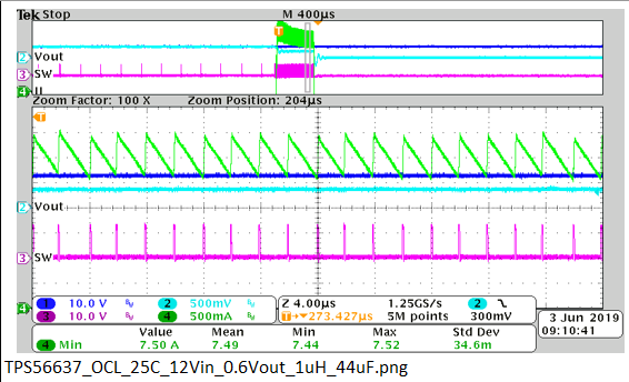

  • Hi Andrew-san,
    Sorry, let me request one more data on this.
    It seems that they can see same behavior in Vout 3.3V condition but it was not same at lower than 0.9V output condition.
    Do you have similar capture when the output is set to lower than 0.9V?
    I wanted to check that point on my bench tomorrow but it seems that EVM has not shipped from TI.com due to some reason...
    Takashi Onawa
  • Hi Takashi-san,
    FYI. 0.6Vout OCL waveform.
    Lishuang
