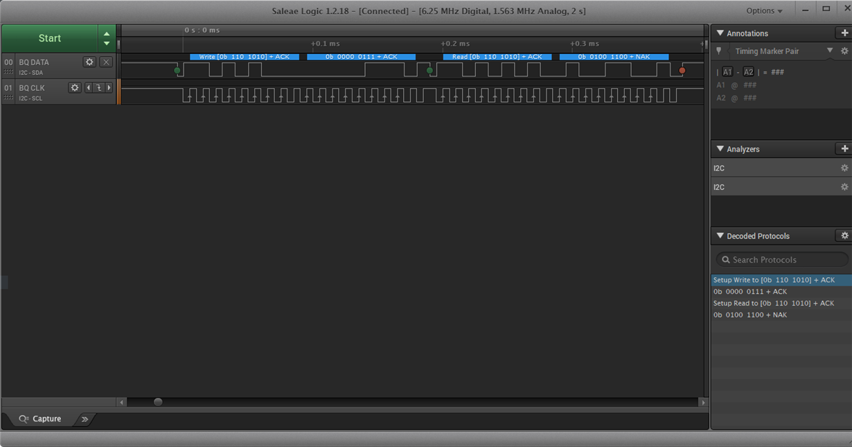

Am Currently working on BQ25619 battery charge case ,am trying to communicate with battery through i2c ,as mentioned in datasheet the i2c slave address for BQ25619 Is 6Ah .
1.My First query is there any change in address when we are writing/reading through I2C ,for example,In these way( 6A << 1),is these Correct way to write slave address or could you tell me the correct I2C slave address for writing and reading the registers
    The I2C address is fixed to 0x6a. This address is used for both read and write operations.

    1.for the answer replied above i have small doubt regarding address while reading slave address for second time in below image mentioned in BQ25619 datasheet ,i have seen after 7bit slave address 8th bit is set for reading(1) so at that time my slave address will missmatch with BQ25619,so i need to change the i2c address while reading or not ....
    2.Below am using i2c write/read functions to establish I2C communication,but  the am not getting acknowledgement from slave,the code is getting struct in while loop,as completion flag is not getting true and am using multiple slaves in my board but with different addresss is it the problem.....
    am trying to read charge control register(0x07) so that i can get status of that register by LPI2C_ReadAccelRegs function ,so that i can confirm the BQ25619 has Communicating with my Target Board.

  • suraj,
    I have just tried it with a logic analyzer and the Figure 22 is correct. I have attached my captures and verified the address on BQStudio as well. It is 0x6a, always.
    Please check your pullup rail voltage and pullup resistors to verify the I2C hardware.
