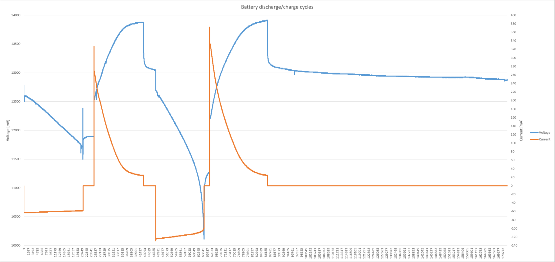

Last week I started a couple of discharge/charge cycles in order to check data consistency on my BQ34Z100EVM and battery Yuasa NP2.3-12FR (12 V, 2.3Ah).
The steps I used (every step is logged, I have a 32Mb file with all data that I may attach if necessary):
- Full discharge from 12.7V to 11.9V, discharge current 60mA, time spent 24hrs
- Sleep for 4hrs
- Full charge from 11.9V to 13V (spike at 13.8V), time spent 20hrs
- Sleep for 5hrs
- Full discharge from 13V to 11.2V, discharge current 120mA, time spent 19hrs
- Sleep for 2hrs
- Full charge from 11.2V to 13V (spike at 13.8V), time spent 20hrs.
Then I let the module and the battery in sleep mode for 4 days.
On Friday morning, when the sleep started, the battery was 100% charged and the "Full Charge Capacity" was at 2215 mAh (very similar to nominal 2300mAh value). This morning, after 4 days in sleep mode and nobody touching anything, the charge level was 0%! Voltage level was 12.8 instead of 13V (acceptable) but "Full Charge Capacity" was at 0 mAh!
I'm using chemistry ID 809 (suggested by GPCCHEM tool) on bqStudio 1.3.102 and no error was marked.
What may cause this behaviour?
Is it normal that after a long weekend in idle the information get lost?
Many thanks,
Best regards.
Massimo
  • Hello Massimo,
    Can you share the log and the .gg file of your test? We will need it to debug further.
    Some common things that may be the issue:
    1. The IT_ENBLE may not be set
    2. Learning cycle was not completed
    3. Safety event set to force FCC to 0
    Sincerely,
    Wyatt Keller

  • Hello Massimo,
    The IT_EN bit will remain set after the command is sent until you send the command again.
    It also looks like the gauge has not performed a learning cycle yet, in appendix D of the TRM you can find the steps to perform the cycle.
    Not all functions run when IT is off, that's why it did update but only sometimes.
    Sincerely,
    Wyatt Keller

  • Hello Massimo,
    I'm not sure if this is the same battery, but your .gg file is set design capacity for 1000mAh and so it will fail if you discharge at the rate in the log you shared.
    For the taper current of charge, this is controlled by the charger, not by the gauge. You're not taking an OCV because the whole log you're charging at a slow rate, your quit current is set at the default of 40mA so you're charging when the gauge thinks it should be relaxed.
    Also your series cell count in the .gg file is set to 6, so your pack voltage max is 2278mV which is very low and most likely not within 100mV to set the FC flag.
    Sincerely,
    Wyatt Keller

  • Hello Massimo,
    Sorry I didn't realize your battery chemistry was lead acid.
    You will need to use a different algorithm for charge termination with this chemistry.
    You can refer to this thread for a document with more information: e2e.ti.com/.../927162
    Sincerely,
    Wyatt Keller

  • Hello Massimo,
    I took a look at the logs, I don't think you are cycling the batteries fully. It also looks like there's two charge cycles before discharge which will interfere with the learning cycle.
    There must be a 90% DOD change from the two relaxation points, right now it looks like 75% or less (DOD0)
    Sincerely,
    Wyatt Keller
  • Hello Wyatt,
    Could you kindly explain better the part regarding the %?
    What should I do exactly?
    Many thanks,
    Best regards
    Massimo Milluzzo
  • Hello Massimo,
    Here's the steps:
    0. Configure dataflash, pack chemistry, perform calibration and export GG File (for later comparison)
    1. Enable IT
    2. Send Reset command (0x0041)
    3. Charge the pack to charge termination.
    4. Rest until the OCVTAKEN flag sets
    5. C/7 Discharge to the termination voltage
    6. Rest until the OCVTAKEN flag sets. At this point, QMax should update and the Update Status should increment to 0x05
    7. Charge the pack to charge termination
    8. Rest until OCVTAKEN flag sets
    9. C/7 Discharge to the termination voltage
    10. Rest until the OCVTAKEN flag sets. At this point, the Ra table should update and Update Status should increment to 0x06
    Regarding the 90% of DOD:
    To complete a full learning cycle, the battery must complete a full charge-relax-discharge-relax cycle. The battery should be charged to the max voltage specified by the cell manufacturer and discharged to the min voltage specified as well to ensure the 90% passed charge condition is met. After a successful learning cycle, the Term Voltage and the voltage the cells are charged to can be adjusted to suit the application specifications.
    Sincerely,
    Wyatt Keller

    Many thanks,
    Best regards.
    Massimo Milluzzo
