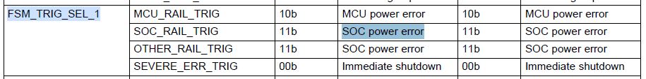

I have found orderlyshutdown and immediate shutdown but the MCU Power error is not explained anywhere in data sheet. The default configuration from PDN_0_A is attached as pic here for us.
Can you please guide me on the MCU & SOC power error.

     The MCU power error means that at least one of the power rail assigned to MCU group has issue of either UV or OV error.
     Same as MCU power error, the SOC power error means that at least one of the power rail assigned to SOC group has issue of either UV or OV error.
     You can read all interrupt registers (address from 0x5A to 0x6C) to find those interrupts bits "1" to figure out the issue power rails.

      I'm not sure if I understand question correctly. Let me try to answer below:
      The error handling sequence when there is a MCU power error and SOC power error could be assigned as followings:
    1.  Immediate shutdown. It means shutdown all power rails immediately; no order at all as its NVM assigned.
    2.  orderly shutdown. It means shutdown all power in the order as its NVM assigned.
    3.  MCU power error. It just generates an interrupt "MCU_ERR_INT=1"; no power rail shutdown.
    4.  SOC power error. It just generates an interrupt "SOC_ERR_INT=1"; no power rail shutdown.
           Please see datasheet Table 5-85. FSM_TRIG_SEL_1 Register Field Descriptions for more details.

    Our System expects the shutdown behavior but in PDN_0_A configuration it is not the expected configuration (Configured as MCU power error and SOC power error). I think we need to change the configuration so that it fits our expected system behavior.
    Also, the interrupts you have mentioned in point 3 & 4 I could not find in the data sheet or PDN_0_A configuration. Any particular reason for it ?

  • Hi, Manish,
      Would you please search "MCU power error" and "SOC power error" again with the latest datasheet from ti.com? I can find them being described in datasheet.

      Both MCU Power Error and SOC Power error don't involve FSM (Function State Machine) and so no Error Handling sequence at all. They just generate interrupts to tell system processor that one of the power rail assigned to these groups has issue and let processor handle the error.
     We apply high voltage (>10% of normal VCCA) to trigger the VCCA_OV condition. When it's triggered, all power rails shall be powered down, but I2C still can access the register to check if the VCCA_OV bit changes to "1".
