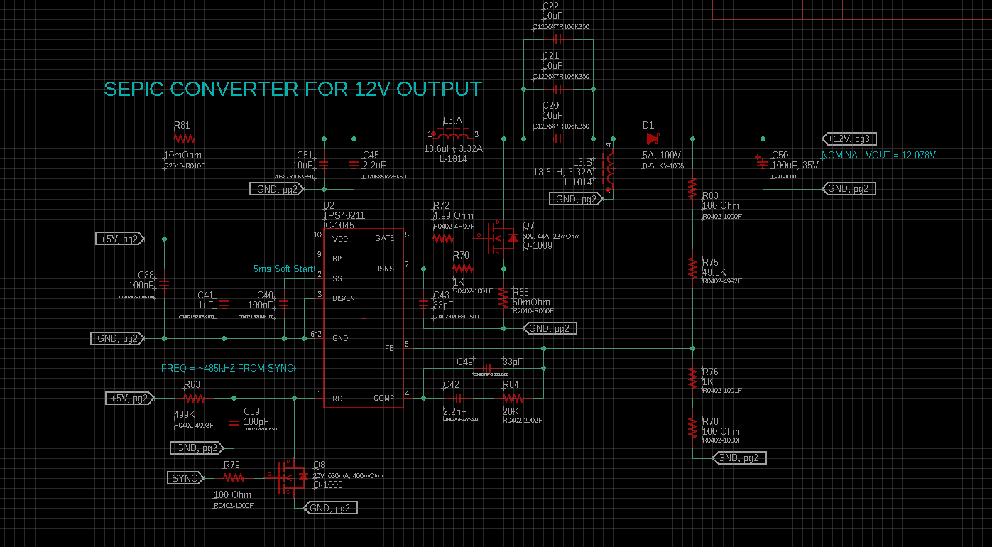

Trying to tie in the RC pin to sync with another controller but is having an issue. without the sync connected, the converter runs at 260kHz and the RC signal looks like a ramp where it goes from 0V to about 300mV. when it connect the sync via an n-channel mosfet that is running at 485khz the RC pin will actually go negative about 150mV and it looks like the ramp is almost inverted.

    Please share the waveform on RT without and with the FET. In addition, please send a schematic how the FET is connected.

    The signal coming in on the sync signal to Q8 is running at ~485kHz at about 45-50% duty cycle.  There is a note on the datasheet about the duty cycle but I have even hooked up an arb to vary the duty cycle from 5% all the way up to 50% with the same result.
    The controller is configured as a sepic converter.

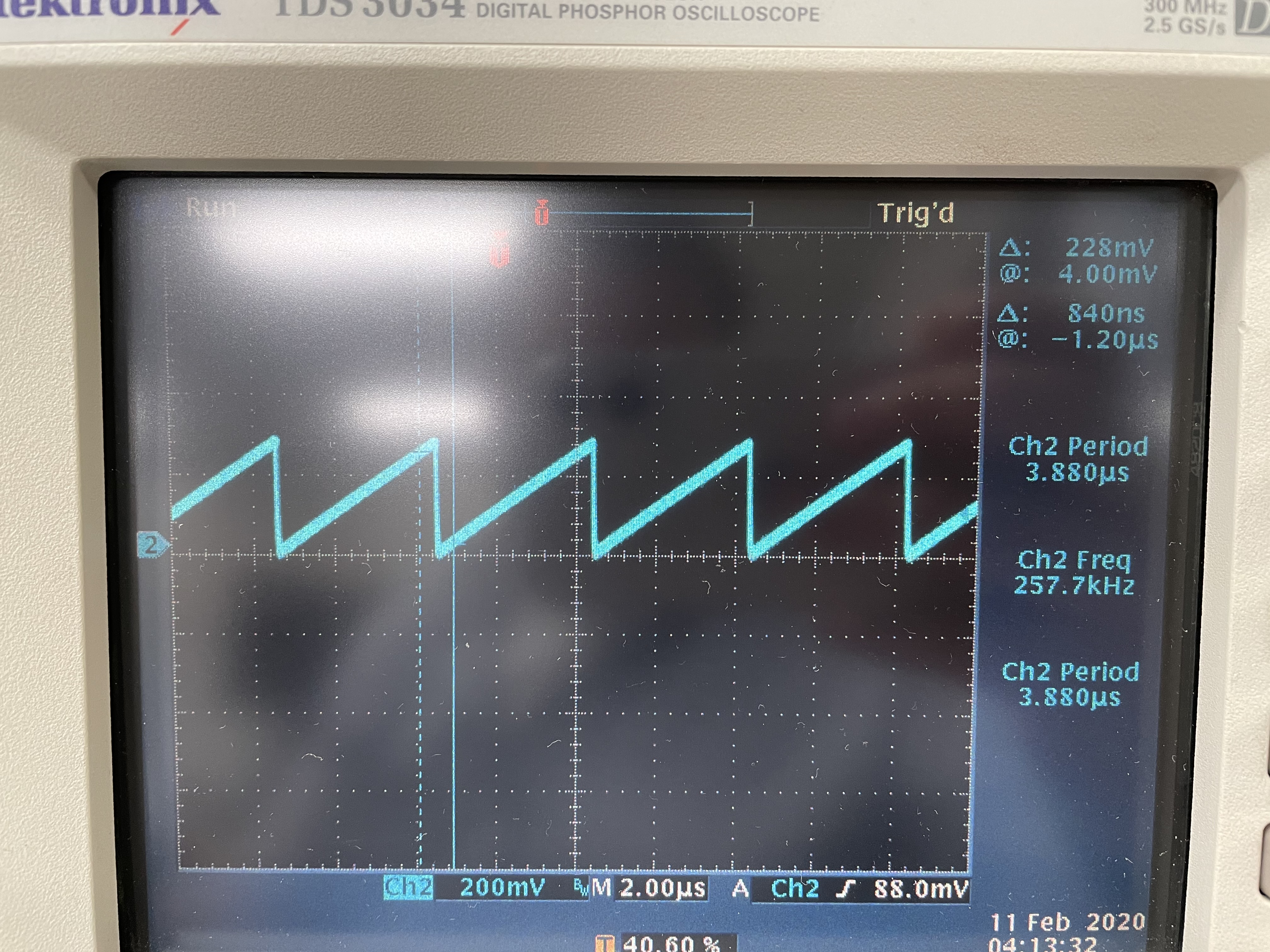

    Here is the waveform of the RC pin without the sync signal hooked up (Q8 gate is tied to gnd).

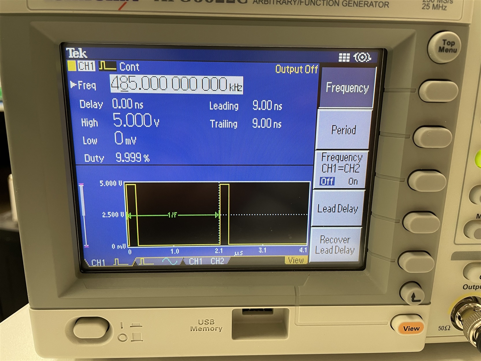

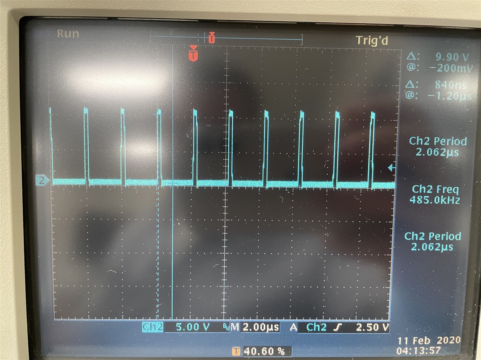

    Using the arb, I set the frequency to 485kHz with a duty cycle of 10% and I feed that into the gate-source of Q8 and to confirm is what I am reading on the gate (note the voltage amplitude is higher on the scope because I didn't have a 50ohm termination on the output of the arb. I did notice the vgs of the signal mosfet is ±6V so I had the mosfet replaced and I even tried reducing the arb voltage and I got the same result)

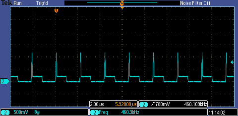

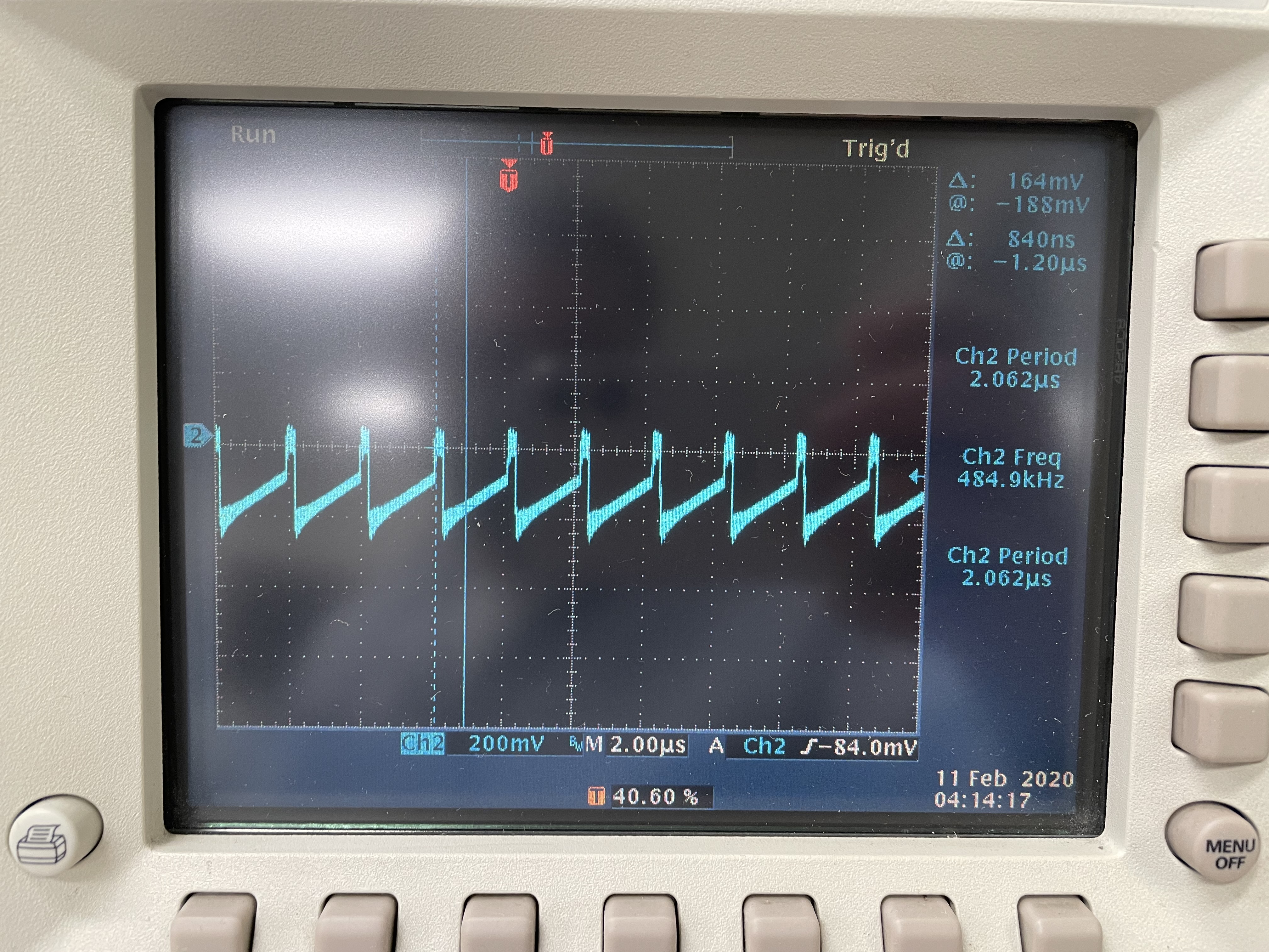

    With the arb signal running or even the default sync signal hooked up we are getting a waveform that looks like the image below on the RC pin.  When Q8 turns on it returns to ~0mV but when Q8 is off it falls to -300mV and then starts to ramp back up.

    Sorry for the late response. We have seen a similar negative voltage when synchronizing with a MOSFET. The parasitic capacitance of the MOSFET causes this negative voltage. Please either use a bipolar small signal transistor or the diode method given as well in the datasheet to stay within the absolute maximum ratings of the device.
