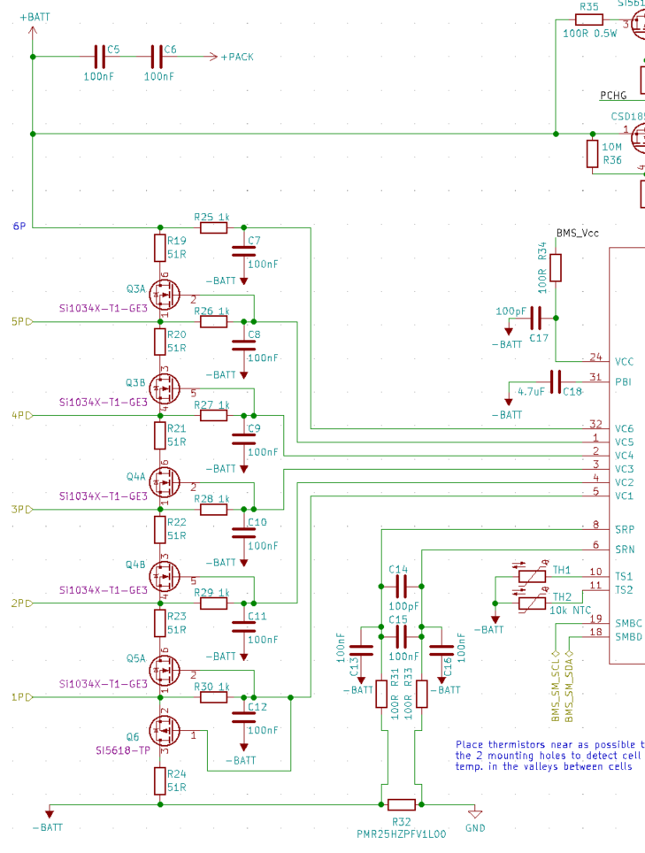

  • Hello Daniel,
    Were you able to measure any current flow between the cells? Can you share the schematic?
    The internal passive cell balancing is very slow, if you have large capacity cells it may take a lot of time to balance.

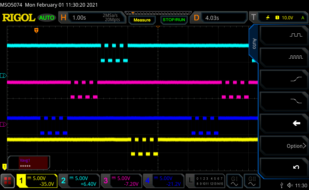

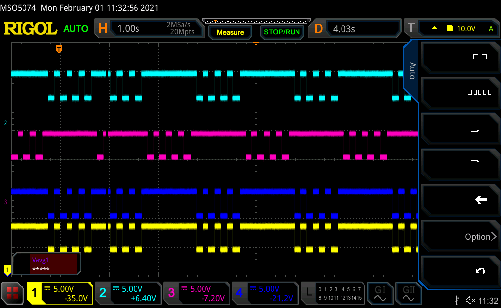

    I understand that internal balancing is slow.  But I have found that with external FETs fitted, I can set the BQ40Z80 to internal balancing, and the external FETs still work.  The only difference appears to be that the FETs cycle through sequentially with it set to external... and with it set to internal, the external balance FETs switch on at roughly the same time.  Oscilloscope screenshots comparing both attached.  Schematic extract also attached.

    CBM=0 (Internal)
    CBM=1 (External)
  • Hello Daniel,
    The gauge uses a capacity calculation to determine how long each cell needs to be balanced, if the chemID isn't a good match or there hasn't been a learning cycle it may lead to issues with cell balancing.
    The reason for alternating is because with external balancing it can happen quicker so it's safer to alternate to not balancing as quickly.
