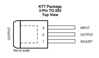

Could you tell where LM317KTTR's thermal pad should be connected? GND is OK?

Unless specifically stated otherwise, the thermal pads are recommended to connect to GND to improve thermal.

I have reviewed the bonding diagram, and I believe for LM317, this is a floating LDO with no GND pin and the thermal pad is actually part of the OUTPUT metal that will be connected to the OUTPUT.
