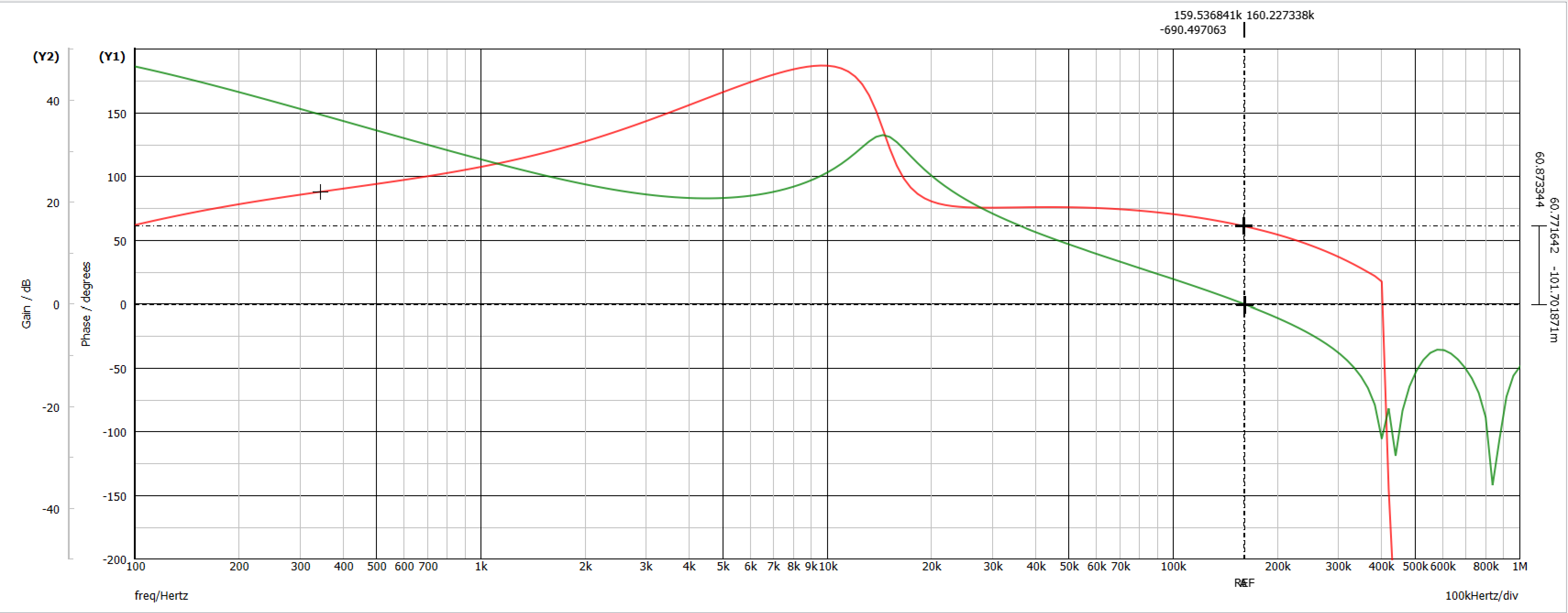

They would like to see if the loop stability is ok by looking at the bode plots, phase/gain margin and crossover frequency. However, in the Webench tool, these are not available for the TPS549D22 (for the TPS54678RTER these are available when they generated the Webench report). Is there an alternative way of getting these details?

    Unfortunately we do not have a math calculator that accurately predicts the frequency domain Gain and Phase plot of the TPS549D22's D-CAP3 constant on-time control like we have for the TPS54678's current mode control.
    I will see if I can put something together for you tomorrow though.

    Based on the default switching frequency and compensation settings of 425kHz Switching Frequency and 1x RC internal ramp time-constant along with 6x
    This looks good and stable, but I am concerned about the DC bias derating and loss of capacitance along with parasitic phase-delays.
    If I reduce the capacitance by 30% (70uF per capacitor) the bandwidth increases to 180kHz and the phase margin drops to 40 degrees, so you will need to check the DC bias derating of the output capacitors and you may want to provide for an additional 1 or 2 output capacitors (7 or 8 total).
