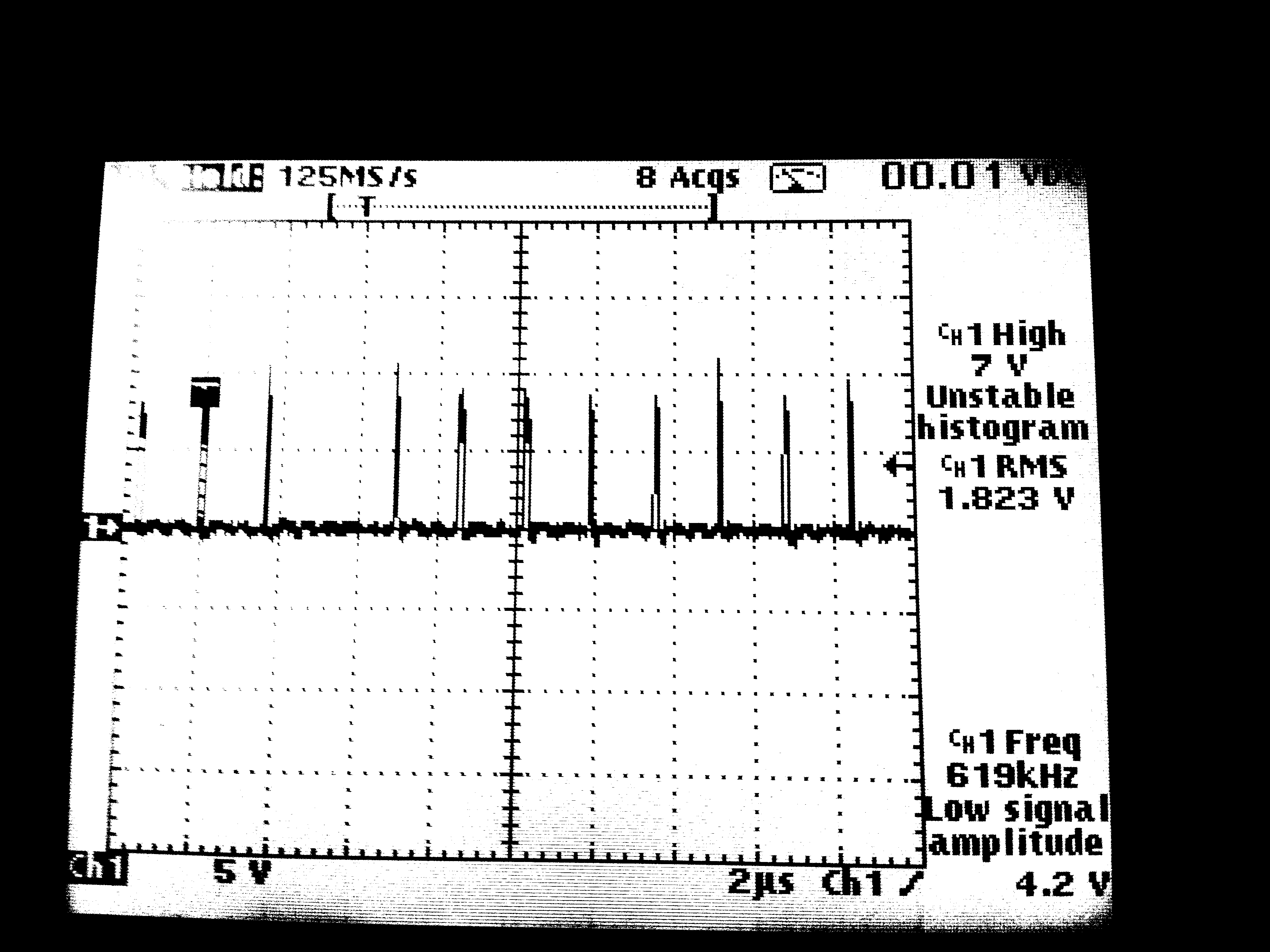

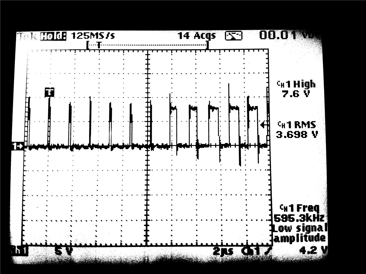

    Desoldered C7 to lower output capacity. Secondary synchronous rectifier replaced by shotky diode. No compensation at all.
    Here are some oscilographs at switcher gate. What could be wrong, very unstable duty, at light load some pulse skipped, at hi load double pulses?
    I tried many RC combinations like 0R + 300n to 120k + 3n3. Am I right that RC should be at secondary and primary side? In calculator it's not clear, There are only Rcom and Ccomp, does it mean same values at both sides?

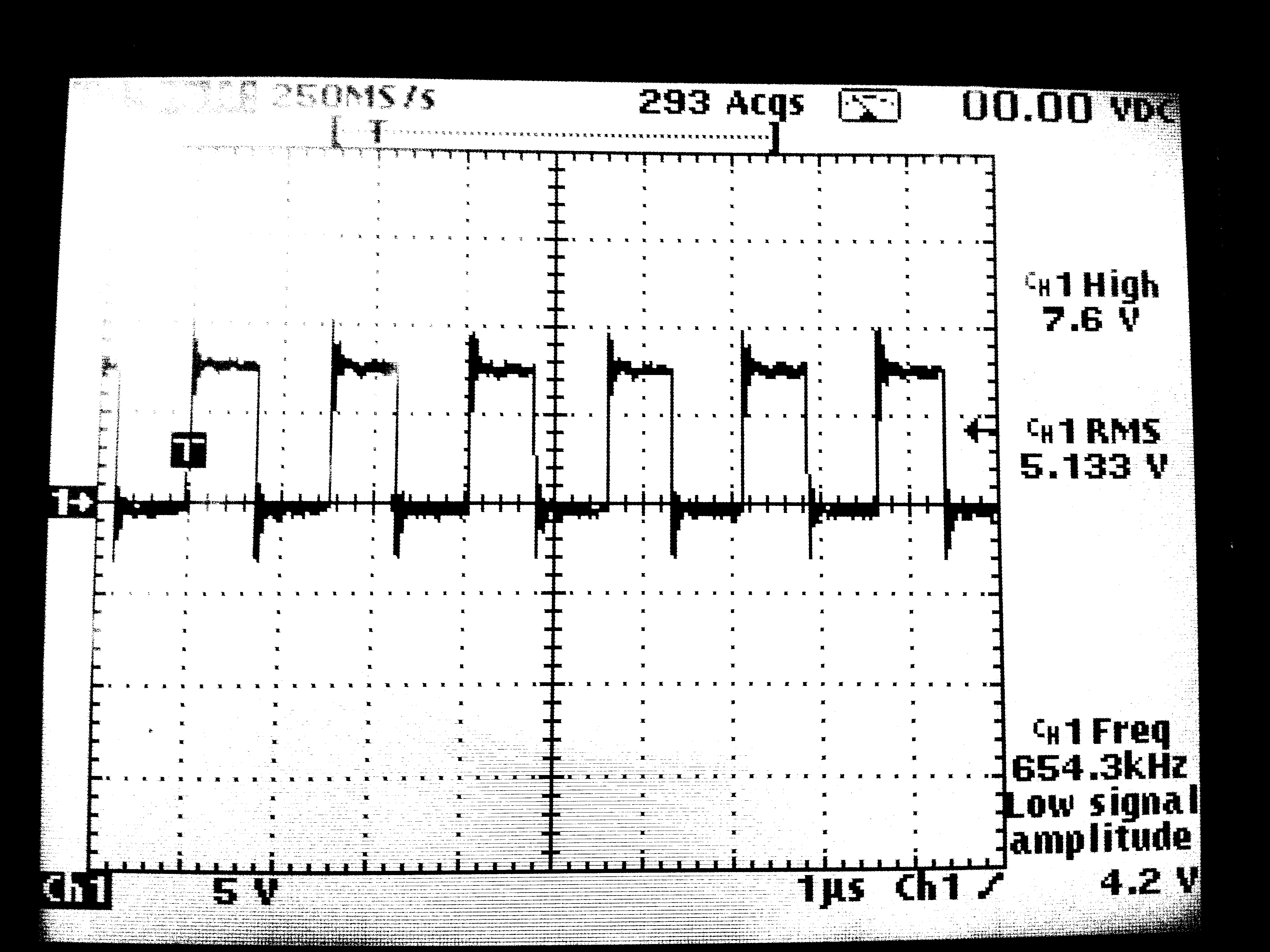

  • Another try:
    removed C22, so now is at output 4576uF. Compensation 22k + 100n at both sides. Removed R50 to disable freq dithering.
    At 0.5A load look ok:

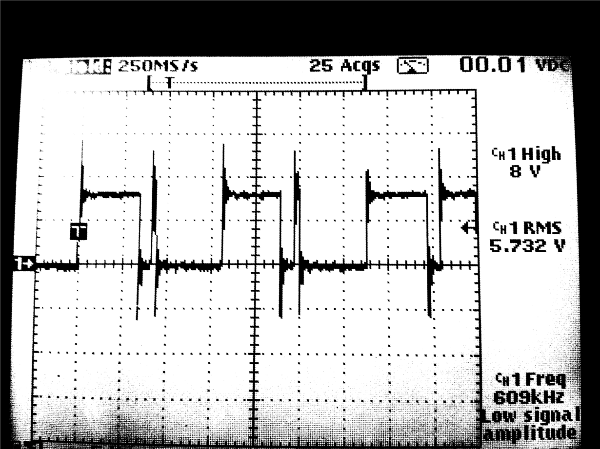

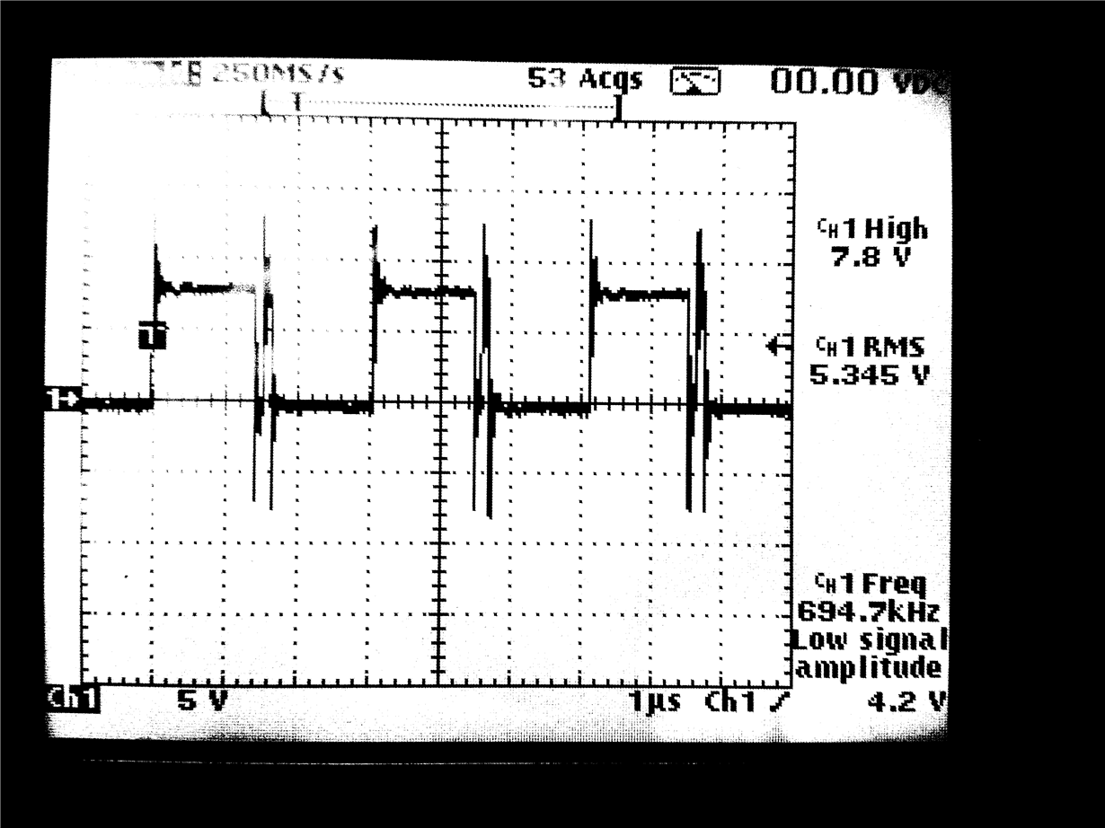

    But at 3A:
    And occasionally load step 0 to 3A cause voltage drop near to 0.
    And what I forget, in all cases the ferrite produce huge noise - with freq dither: something like white noise, without: noise with dominant some audible freq..
