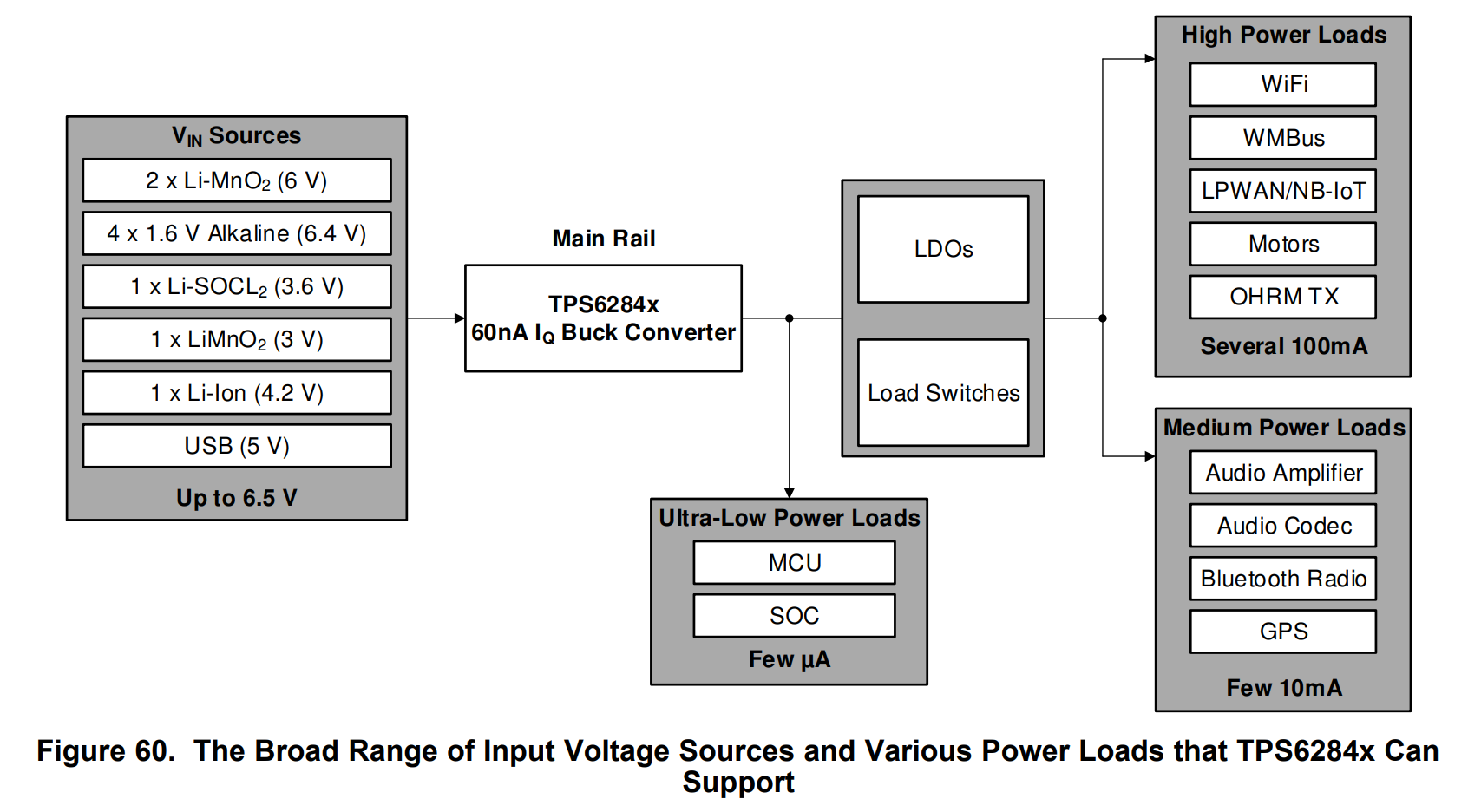

The part selector website is a bit unclear because it states that this buckconverter has a Vout max of 3.3, but when checking the datasheet it is actually only selectable as 1.2 or 1.8V. So is there a version of this IC that has a 3.3V output?
I am looking for the following:
  • 3.3V Vout
  • 2.6-5.5V Vin
  • Iout max 300mA (between 100 and 200mA is fine too)
  • Iq typ < 1uA
  • An enable pin that connects Vin to an output pin which can be used to measure the battery voltage on an ADC with voltage divider, but only when the enable pin is switched on.
The TPS62746 ticks all the boxes except that it only supplies 1.8 or 1.2V output.
