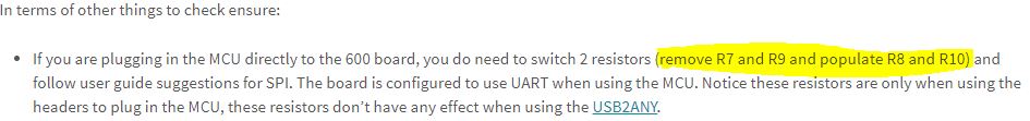

    Yes the mcu code was wrote for TMS570LS1224 in the LAUNCHXL2-TMS5012. I have forwarded this thread to TMS570 team rather than bq79600 team (which I support) to receive feedback from the TMS570 team regarding which one you may have. This seems to be more of an issue regarding the MCU/CCS.
    In terms of other things to check ensure:
    • If you are plugging in the MCU directly to the 600 board, you do need to switch 2 resistors (remove R7 and R9 and populate R8 and R10) and follow user guide suggestions for SPI. The board is configured to use UART when using the MCU. Notice these resistors are only when using the headers to plug in the MCU, these resistors don’t have any effect when using the USB2ANY.
    • I’ve had issues to communicate when using longer wires to connect the MCU to the 600. You get a much cleaner connection but plugging in the MCU directly to the 600 EVM.
    Taylor

    The R7, R8, R9 and R10 are populated. R10 is a external pull-up resistor to nRST signal. R8 and dR9 are used to calculate the threshold which triggers the nPORRST.
    I'd like to know the reason for removing R7 and R9.
  • Hi QJ,
    The R7, R9 vs R8, R10 topic is related to the BQ79600 boards.
    R7 and R9 connect to M_Rx and M_TX and R8 and R10 connect to M_SOMI and M_SIMO.
    but this is not the issue right now ;)

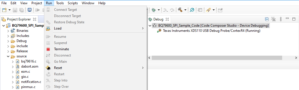

    All "new" ones have the same IDs and don't run the code at all, not even the 'printf' in the beginning
    (but code composer says running, see last post)

    And also no new Error-Messages or any more information from the CCStudio.
    It just continues to flash and run (but it never starts running).

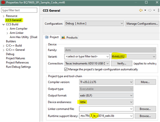

    I just noticed that the new board you are using is RM46 rather than TMS570LS1224. RM46 is a little endian device, but TMS570LS1224 is a big endian device. To use TMS570LS12x SW on RM46 device, you need to do some minor code change.
  • Hi Collin,
    Can you share the "SPI-example" for BQ79600, so I can help you modify the code for RM46 device? thanks
  • sure, I've already sent the file via private message. would be great if you could help.
  • Hi Collin,
    I am sorry. I am not able to download the file. Please send to my email. Pleas find my email address in the private message. Thanks
  • I checked your project. DMA is not used in SPI transfer. The code can be used for RM46 without modification except for the project property:
    1. Device variant
    2. Device endianness
    3. Runtime support library
