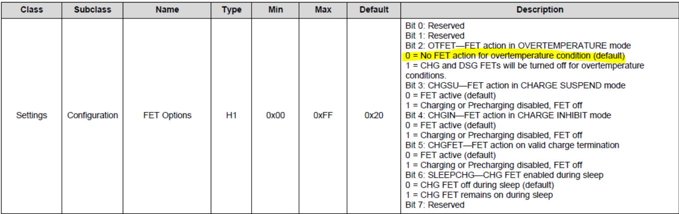

I are conducting high and low temperature test.
At low temperatures, both UTC and UTD were set to 1, and XCHG and XDSG flags too
However, at high temperatures, both OTC and OTD were set to 1, but the XCHG and XDSG flags were not set to 1.
I referred to the sluu81 document, but it was not resolved.
