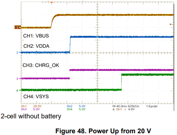

    The BQ25703A is a NVDC charger with minimum system voltage regulation. Even if the battery is absent or deeply discharged, VSYS should be regulated above the MinSystemVoltage() setting as long as the adapter is present. For example, Figure 48 in the datasheet shows that VSYS is regulated above the MinSystemVoltage() after VBUS is plugged in, even though there is no battery connected.

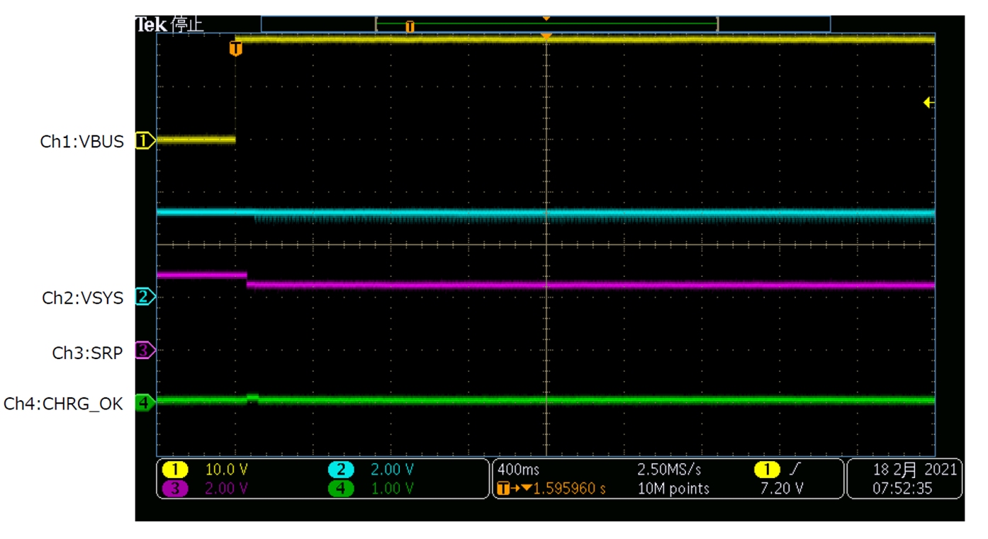

    Also, can you please capture a waveform showing VBUS, VSYS, SRN, and CHRG_OK for each of the following 2 power-up sequences?
    1) Deeply discharged battery already connected, and then the adapter is plugged in.
    2) Adapter already connected, and then the deeply discharged battery is plugged in.

    Could you check the following waveforms?
    They did not capture it because each waveform didn't vary.
    Kuramochi
  • Hi Kuramochi,
    Thanks for capturing the waveform. I'm concerned that CHRG_OK does not go high. CHRG_OK should go high when a good input source is connected to VBUS.
    As a sanity check, can you try plugging in the adapter when there is no system load and no battery connected? Does CHRG_OK go high in this case? We expect to see a waveform very similar to Figure 48 in the datasheet. Can you please read back the ChargerStatus register from the BQ25703A to see if any fault conditions are reported?
