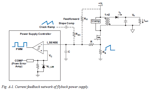

According to the thread listed below, it is recommended to use.
However, it cannot be applied to PMP11254.
RSC does not exist in the connection diagram of PMP11254.
Could you please let us know how to calculate Rff.

    The formula and the figure are from SLUP261.

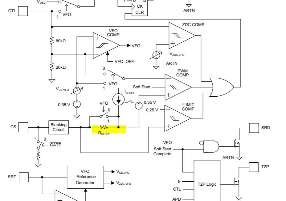

    This resistor is internal to the IC. The value is not listed in the datasheet.
    I will note, Rff is in PMP11254 as R36 --- is there a reason you cannot use this value?

    I understand Rsc is device inside.
    It is no problem to use the value of R36(750kohm).
