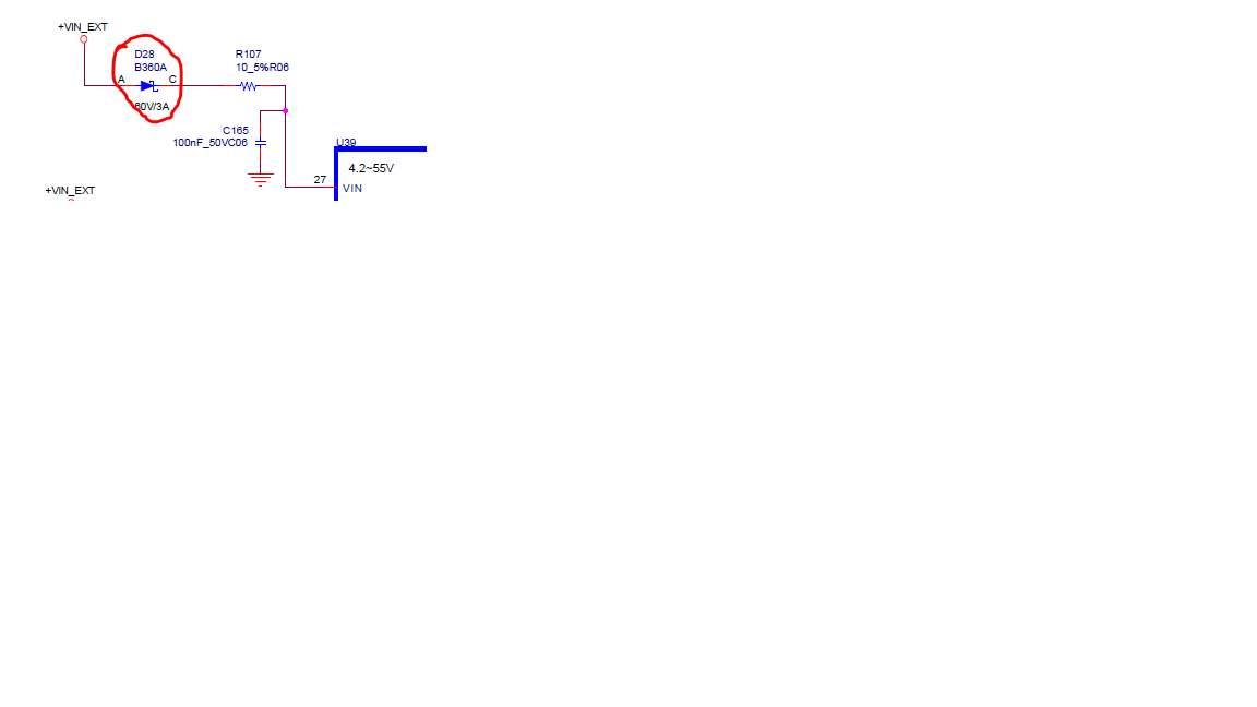

1.Could you please check the LM5176 schematic as below and any need to adjust
2.What is the function of Dvin? Can it be replaced by BAS316 250mA or can be removed

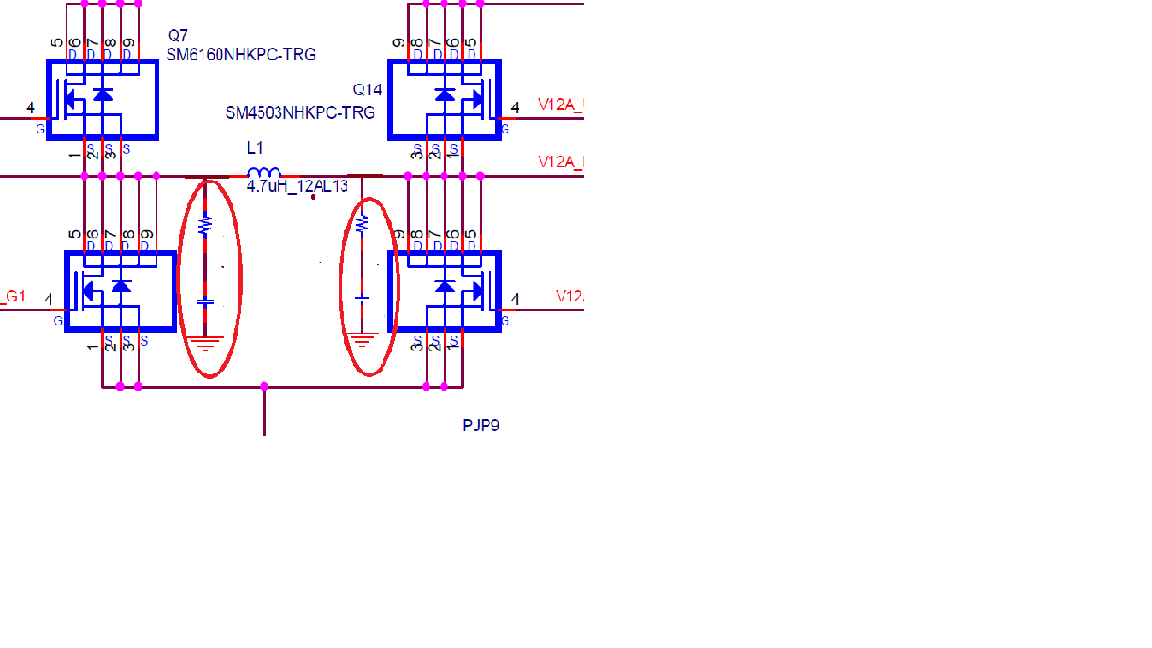

    - Place the snubber on SW2 above the upper transistor not the lower transistor. The snubber should be connected on the synchronous rectifier, not the power transistor.

    2. Yes, see above for the function.

    1. Place the snubber on SW2 above the upper transistor not the lower transistor. The snubber should be connected on the synchronous rectifier, not the power transistor.
    Modify it to the following picture?
    2.Sorry I didn't see the suggestion for question 2, Can the Vin  blocking diode be replaced by BAS316?

    1. Please move the one on the right side across Q14. The left one stays were it is.
    2. Yes, it can be replaced, but as long as there is no external voltage on BIAS, it can be replaced by a short.
