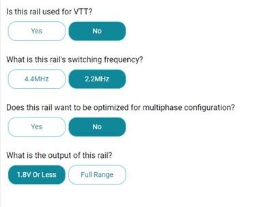

where can i find documentation about the buttons in the GUI asking
VTT usage
Switching F
Multiphase usage
1.8V or less

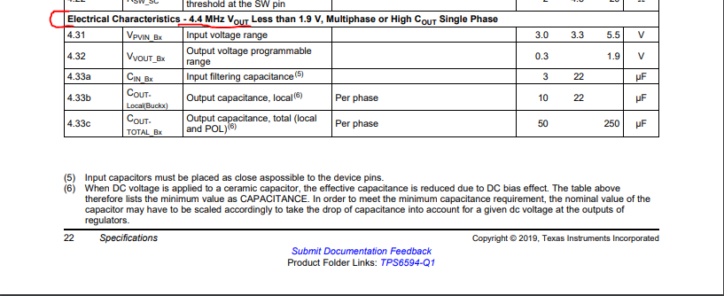

These buttons are related to the configurations described in the datasheet:
As you select different options you will see that the description will match one of the configurations. See also the gui users guide:
"Within each block are a list of registers and fields which directly match the device register and field names. It is recommended to use the data sheet specification to understand and properly set the field values for a given application. Within the BUCK blocks there is an additional graphical selection tool, see Figure 8-4, to abstract the register settings into the use cases also described in the device data sheet. The graphical selection tool will appear in the far right column of the display, providing the Configuration Use case name as well as the recommended inductor value."
