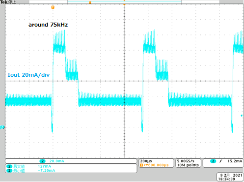

My customer have an issue about output current noise with LM2663.

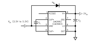

Configuration : Positive doubler
output current waveform
Diode(D1) :  Customer try to change Diode from SS355VMTE-17(Vf=1.2V) to RB520SM-30 (Vf=0.58V) Because, the datasheet is recommended low Vf diode.
Then this noise is little bit improved. Could you please let me know the reason for it?
Also, Could you please let me know your recommendation for diode Vf (max)?
Noise frequency  : around 75kHz
I think, It is switching frequency, right?
Datasheet is described Fsw = 27.5kHz(min), 75kHz(Typ). Could you please let me know the maximum value?
Also, what parameters does this variation depend on? (Temp/ Vin/ unit variation/ something like that)
Do you have any idea for the avoiding current noise?

    You mean the spikes that are on top of the output current waveform, correct?

    > You mean the spikes that are on top of the output current waveform, correct? : Yes, I mean the spike.
    >Which type of capacitors are you using? :  Ceramic capacitors
    Is this noise affected from the characteristics of the diode? Also, Could you please let me know your recommendation for diode Vf (max)?

  • Hello Muk,
    I would recommend to add a small high-frequency capacitor parallel to the output capacitor close to the IC which is still capacitive at the frequency of the noise spikes (the rise and fall times of the spikes are important, not the switching frequency). The output capacitor used at the moment is most probable already inductive at this frequency.
    I do not expect that the diode influences these spikes. The forward voltage is not too important as it only makes sure that the difference from VIN to VOUT is not getting too big at startup. Just use one diode and not 2 in series.
    The series resistance of the flying capacitor does, so a resistor in series there could be helpful, but this reduces the efficiency.

    I  requested adding small capacitor like 0.1uF/0.01uF for output capacitor and flying capacitor.
    They tried to add 0.1uF. But, the noise was not improved.
    I will try to suggest the series resistance of the flying capacitor.
    Muk
  • Hello Yusuke,
    Did they add small high frequency caps to the flying cap as well as the output? If yes, they only should add the high-frequency cap to the output. And this small cap needs to be as close to the IC as possible.
